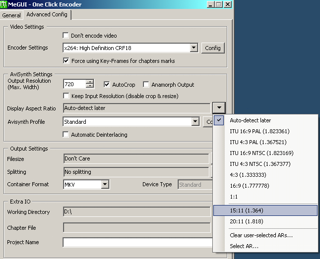

    I don't use the OneClick encoder but when you add a script to the job queue via the queue button in the Video section of the GUI, MeGUI uses those claues to calculate the correct pixel aspect ratio (when anamorphic encoding is enabled in the script creator). What OneClick does if you load the same script for encoding, I don't know.
    Or check in MeGUI's options to see if the "use ITU aspect ratiio" option is checked. That should make the aspect ratio fairly close to 15:11 when MeGUI opens a 4:3 video.
    Can't you over-ride the aspect ratio in the OneClick encoder? You'd probably need to create a custom aspect ratio if you want exactly 15:11 (ITU is very close, but not quite the same).

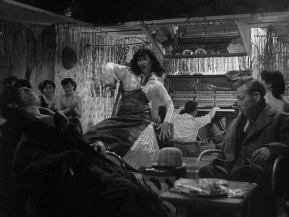

    Thanks for this thorough contribution. I kinda renounced re-encoding this particular movie myself (which would require letting my computer -- midrange 2009 config -- run a whole day to get a good result, with QTGMC and x264 preset "slow", considering it's 2h23min long) after others convinced me I could find better quality alternatives (and indeed I did), but it's still an opportunity to learn some new tricks.
    The output looks cleaner and sharper than the source (plus the aspect ratio is more realistic -- but maybe VLC player has trouble displaying ITU standard correctly) :
    http://share.pho.to/9lkTj
    But comparing it with the higher definition file I downloaded yesterday (third picture), the quality gain doesn't seem so obvious : the woman's face is more defined, but the overall picture seems softer, less sharp, while the "colors", or rather the shades of grey seem duller. Arguably it's not a high quality conversion (just 800kbps for 960x720 resolution, 954MB for 2h23m), but it shouldn't affect things like colors / contrast, should it ? Or is the PAL DVD video artificially oversharpened with enhanced contrast or boosted white balance, giving me a wrong impression ?

  12. It's your DVD video that has crappy levels, no true blacks, blown out brights, and contrast pumping from an autogain filter. It also has severe oversharpening halos (what you're interpreting as sharpness and looks terrible when blown up on a big screen), impure greys, has been over compressed, etc. It was obviously made from a poor NTSC to PAL converted video tape. Here's the same frame from a cleaner 960x720 version I found (~7 GB x264 mkv):
    Even this I doubt is from the Criterion Blu-ray release. It's got lots of scratches, film bounce, etc.

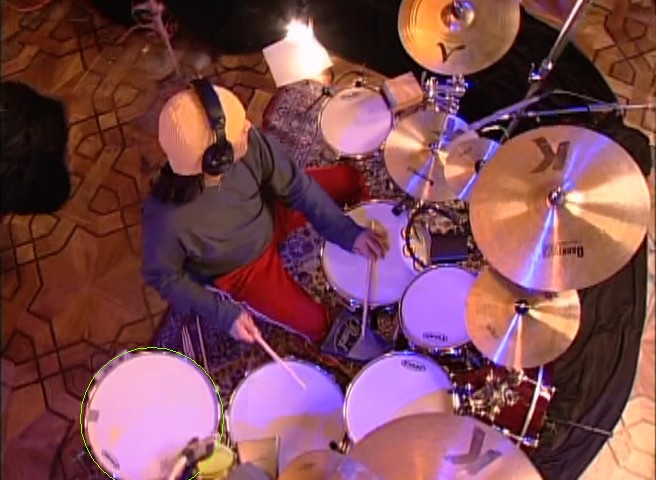

    There's no way for a player to know if a DVD should be ITU or not. All software players I know of resize to exactly 4:3 or 16:9. I've often wondered why they don't use ITU for 4:3 DVDs, given I'm pretty sure 99% of 4:3 DVDs would be ITU. Maybe people would complain if a 4:3 video doesn't completely fill a 4:3 monitor. Using 16:9 for 16:9 DVDs makes more sense, given ITU 16:9 DVDs are probably in the minority.

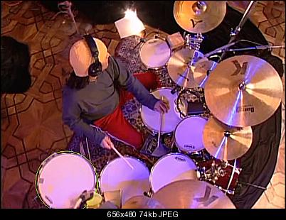

    Those drum DVD I have to encode which are in 4:3 (like the one from the other thread I created the other day), I'm pretty sure they're strictly 4:3 (no black bars on the sides, and 4:3 / 1.3333 feels "natural"). But for films, indeed, it seems to be the vast majority.
  18. Originally Posted by abolibibelot View Post
    I'd vote they're ITU. There's ITU-like black down the sides in places (it only takes 8 pixels each side for the video width to be 704).
    I don't trust my eyes completely, and I've been convinced something is ITU (or not) then come back another day and wondered what I was thinking, but surely somewhere in those DVDs there's a straight on shot of something round, given drums tend to be round in nature.
    This is the closest I could find in your samples. It's not straight on, but close. Even the "draw a circle" test was fooling my brain, because I could draw a circle around the floor tom in both pics (a perfect circle each time) and when I switched between them it looked like the drawn circle was changing shape along with the picture, even though it can only change size. When I got the drawn circles pretty much the same though, the image starts to look ITU to me. And without drawn circles, the snare drum looks like it's round in the ITU screenshot, but that's just me.....
    4:3
    ITU:
    Edit: I thought I'd add.... I'm fairly convinced DVDs aren't always the correct aspect ratio, whether they're officially ITU or not. I was encoding some old 16:9 DVDs of Stargate SG1 a while back. The aspect ratio of MGM's roaring lion at the beginning of each episode wasn't exactly the same each time, and in one episode there was a shot of a diagram of a stargate being displayed on a laptop that was almost round, it faded into another diagram of a stargate on a computer screen that was squashed like a football, and it faded into a screenshot of a stargate that was actually round.... if you didn't use ITU resizing. How stuff like that goes unnoticed, or how/why it ends up that way, I don't know... but I'm fairly sure the pilot episode was ITU while the rest were not, although I couldn't prove it to myself.
    And recently I've encoded quite a few different 16:9 DVDs containing BBC video, and developed a theory all BBC 16:9 DVDs are ITU even if there's no black down the sides. I can't prove it either, but I'm fairly convinced.....
