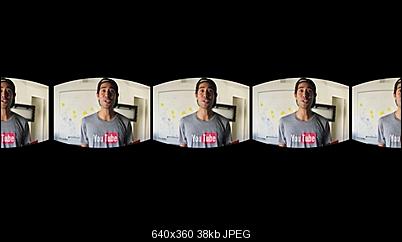

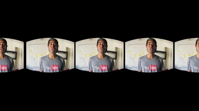

  5. Originally Posted by pietstreepjer View Post
    I found it in this YouTube video: https://www.youtube.com/watch?v=oiojqF-60MU. I'd like to make a video with the effect you can see from 0:01 - 0:05 and from 1:32 - 1:46, but instead of having the same video placed 4 times, I'd like to have different videos in the different directions.
    Are you sure you got the times correct? You wanted the linear view (side by side) ?
Name:	Heroes in 360 - YouTube000024.jpg
    [Attachment 33948 - Click to enlarge]
    Thanks for your reply. Yeah that's exactly what I mean! I'd like to have the linear view, but instead of having the same video 4 times, I'd like to have 4 different videos. My idea is to make 4 completely different video clips for the same song and put them side by side so you can turn around whenever you want in 360 degrees and switch over to another video.

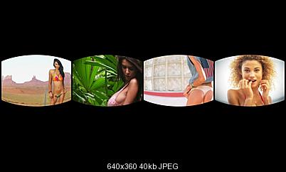

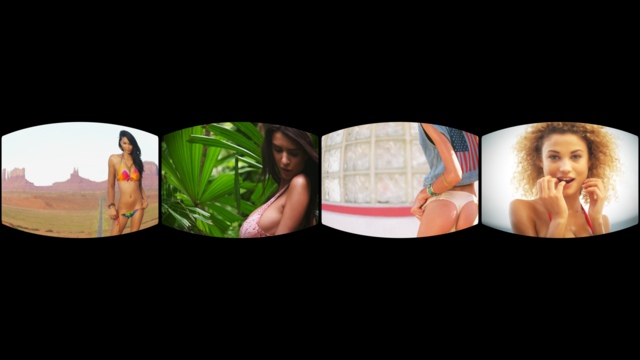

  14. Proof of concept, using free tools avisynth, defish() plugin . I just "eyeballed" the values and some trial and error. There is probably a mathematically correct way to do it, but my math isn't that great
    ***Warning: semi NSFW because Sports Illustrated video is used ***
    "2015 Sports Illustrated Swimsuit Tease" - also on YT
    360 Test
    https://youtu.be/wpN8E8XICCM
    w=608
    h=342
    cr=72
    ab=8
    a1=0.15
    b1=-0.05
    c1=-0.05
    orig=FFVideoSource("2015 Sports Illustrated Swimsuit Tease - YouTube.mp4").assumefps(24).converttorgb32(matrix="rec709").spline36resize(w,h)
    a=orig.trim(360,600).Defish(a=a1, b=b1, c=c1).crop(cr,0,-cr,0,true).addborders(ab,0,ab,0)
    b=orig.trim(601,842).Defish(a=a1, b=b1, c=c1).crop(cr,0,-cr,0,true).addborders(ab,0,ab,0)
    c=orig.trim(843,1083).Defish(a=a1, b=b1, c=c1).crop(cr,0,-cr,0,true).addborders(ab,0,ab,0)
    d=orig.trim(1084,1324).Defish(a=a1, b=b1, c=c1).crop(cr,0,-cr,0,true).addborders(ab,0,ab,0)
    bl=blankclip(240,1920,1080,pixel_type="RGB32").assumefps(24).killaudio()
    left=a.crop(0,0,-240,0,true)
    right=a.crop(240,0,0,0,true)
    strip=stackhorizontal(right,b,c,d,left)
    overlay(bl, strip, y=(bl.height/2-strip.height/2)) #
    ConvertToYV12(matrix="rec709")
    There is a bit of a learning curve to avisynth, but you just substitute your videos for a,b,c,d each resized to 608x342 for a 1920x1080 template base video . I used the video in post#1 as a template to get the rough size, orientation, angle . Someone could probably write a wrapper function to automate this and make it even easier to use if the values are considered to be correct (I just roughly guessed the values so far)
    It should be possible in any NLE or AE, you just have to deform each video and assemble the just like the 1st video (the linear strip)
    I used these instructions to upload to YT (all you really need is to inject the 360 metadata with the tool linked), there are no other special steps on uploading
    https://support.google.com/youtube/answer/6178631?hl=en
    EDIT:
    Since you said you used AE, It's pretty easy to do in AE too.
    1) Create a 1920x1080 composition
    2) Precomp each of your videos (There are really 4 precomps, but #1 is used twice because it's split into the two "ends") .
    3) Apply Optics Compensation effect to each with FOV set to 90.
    4) Drop a white solid on top of each with 1272x1080 dimensions, set to luma matte (this will create the side edges cut off like in the example video in the 1st post)
    5) Put the 4 precomps into the main composition, plus a duplicate of #1, each scaled to 37%
    5) The x-position will be 0,480,960,1440,1920 for each of the 4 precomps (#1,#2,#3,#4,#1) , respectively
    DONE!
    Since this is a template, and all you have to do is swap out the videos in each precomp
    AE test (same video on all sides, just a lazy test)
    https://youtu.be/5t46EQ9DLFI
    I do notice the peripheral edges are smoother in AE (not as "serrated" or jaggy), perhaps the optics compensations is apply some anti aliasing. You could do the same in avisynth if you wanted to

  17. Originally Posted by pietstreepjer View Post
    I made a video, thanks to you. The result looks almost perfect, but when I upload it to YouTube you can see a the stitching line. It's the same for your video. Do you think it's possible change the settings in the AE file in a way so the stitching line will be placed between two videos (in the black background)?
    Thanks in advance
    Yes, the line is there in the video in post #1 also. I just followed that template . If you look at the screenshot in post #5, it's from the first and last being split
    You should be able to delete one (so there are four instead of five), and shift them all over. So it should look like this with four "boxes"
    Easiest way to shift them all at once is create a null object, parent the remaining four to the null then move the x-position of the null to 1200
    https://youtu.be/rsQImsr4g6M
    But youtube starts the video viewing at a vertex corner instead of straight on one face, perhaps that was why it was done that way in post #1
    Thanks in advance
    [Attachment 33970 - Click to enlarge]
    Sorry for the late reply, but thanks man! I'm very happy with this! I've tested it and it worked! Gonna make a 360 video clip now! Thanks again for your replies.
