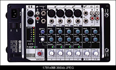

    Yes...I set the CH Select switches to Input and checked the audio control knobs. On the mixer, I connected the cable into the XLR slots and hit the LINE button. Are the XLR slots REC OUT jacks? Or do I have to use RCA cables? I've attached a photo of the mixer.Click image for larger version

    The XLR jacks are inputs to the mixer. You need to use the RCA jacks with the funky little picture above them. Please do avail yourself of the fine manual.
  9. You can use RCA to XLR or you can use this:
    http://www.amazon.com/Monoprice-104760-3-Feet-Premier-Series/dp/B001UJGNMO/ref=pd_bxgy...3JX1VXEWSFJ9VR
    connect it to the jack next to the RCA out, set the camera at LINE level.

    Yeah, since XLR cables are designed with signal flow in mind, they standardised on Female (input) to Male (output), so the "need" for male-male turnarounds was a giveaway.
