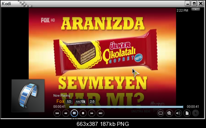

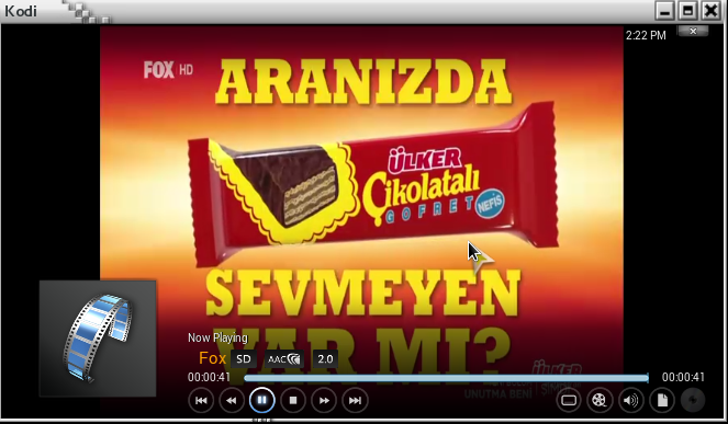

    hi
    try without user-agent
    <item>
    <title>Fox</title>
    <link>$doregex[get-M3U8]</link>
    <regex>
    <name>get-M3U8</name>
    <expres>file:"(.*?)"</expres>
    <page>http://www.canlitvlive.net/izle/fox-tv.html</page>
    </regex>
    </item>
  19. hi
    <item>
    <title>Fox</title>
    <regex>
    </regex>
    </item>
    Hi, thanks for the answer.
    I have tried without user agent but no luck.
    Which version of Kodi are you using? Any other ideas why it is not working? (maybe geoblocking?)
  20. Ok, I think I am narrowing down the problem.
    My Kodi is running in a Raspberry Pi 2 (using Raspbian).
    If I extract the stream URL (e.g. http://yayin8.canlitvlive.net/foxtv/live.m3u8?tkn=LQJ_l2n4nC0440EvDRd9ig&tms=1447940605)
    - in Windows browser, it gives me the option to open it in VLC.
    - in the Raspbian browser, directly I get the error "403 Forbidden nginx/1.7.4"
    Is it possible that they are filtering by OS?
    Is there any way to change that, in the same way we manipulate the user agent?ç
    Thanks!
  21. SOLVED IT!
    It must have been a problem with IP blocking (not geoblocking).
    I was accessing with my VPN from a particular server. I changed the VPN server and now it´s working.
    Again, thank you very much for your support.
