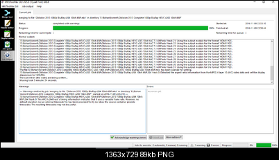

  27. I just encoded x264 10bit and can't solve an error. This is the file I used for encoding http://komisar.gin.by/old/2721/x264.2721.10bit.x86_64.exe
    I don't know if kMod is better! Is it? http://komisar.gin.by/
    Anyway, the file was encoded successfully and this was the error I got -
    "This AVC/h.264 track's timing information indicates that it uses a variable frame rate. However, no default duration nor an external timecode file has been provided for it, nor does the source container provide timecodes. The resulting timecodes may not be useful."

    The different modified x264 builds differ only slightly, merely regarding extra modules for input and output, but not regarding the x264 core encoder.
    The error message you quoted is probably not exactly an "error" (in this case, the conversion would have been interrupted), just a "warning" (the conversion finished, but the result may not be what you expected). It means that it has detected that the playback speed is not constant, but there are scenes which play faster and other scenes which play slower. But it misses a reliable and explicit table of frame rates which could be used to reproduce the changing speed in the resulting file. I don't have experience with such a case; one possible consequence may be that you need a tool which can extract such a list from your source, the other may be that these differences are so tiny that you may not notice it, just even at the limit of numerical precision.
    Which tool reports this error? And how did you use your x264 encoder, did you try to load a source file directly with the help of libavcodec input modules in this modified x264 build, not through an AviSynth script? Details, details, details...

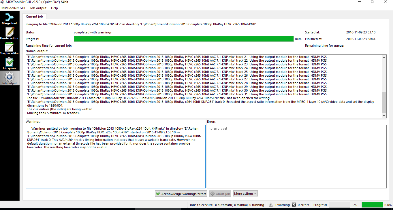

  29. MKVToolNix reported this error Click image for larger version
    I used this build - http://komisar.gin.by/old/2721/x264.2721.10bit.x86_64.exe
    and this is the command line I used
    x264 --vf crop:0,138,0,138 -o "output.264" "input.mkv"
    All the settings were default.
