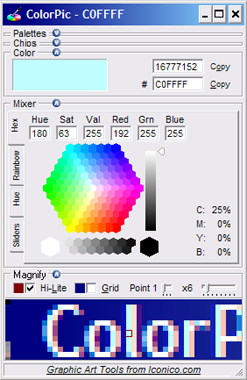

    Very good suggestion and essential for checking color and levels. But ye olde Csamp.exe is getting tough to find these days. Csamp has no installer, it's a small standalone app that puts its icon on your desktop. Click to run it, and the Csamp panel appears. Simple instructions included in the attached zip.
    It deactivates if you click on other windows, so it puts a tiny blue icon in your taskbar tray that you can click if the panel disappears.
    If you want something that runs all the time you can try the free ColorPic from http://www.iconico.com/colorpic/. The window has several panels that you can open and close. Below is ColorPic with three of its panels open and the others closed:
