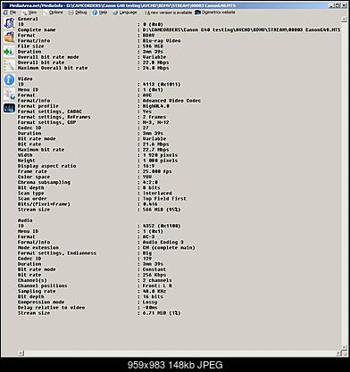

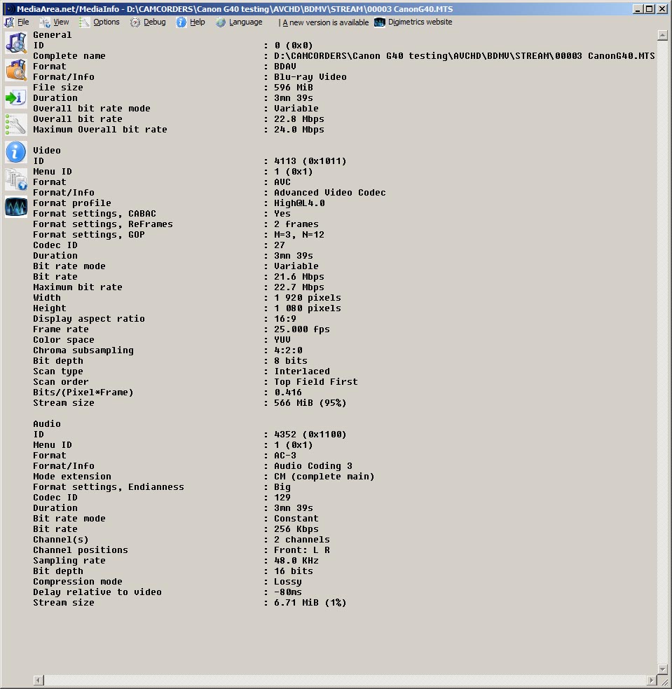

  5. Switch MediaInfo to View -> Text. That will tell you if the video is interlaced or progressive.

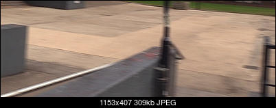

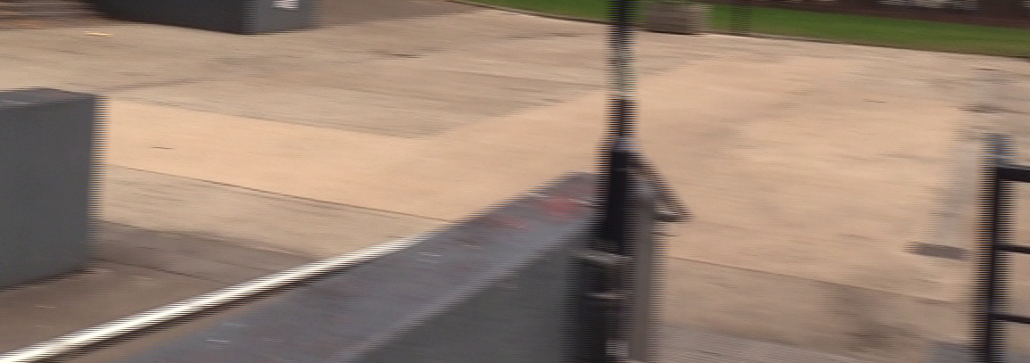

    Otherwise, I don't know what you mean by "thin alternate pixel black lines of a mm or two along edges when video moves horiz". Post a sample image showing the problem.
    Sep 2007
Name:	MediaInfo G40 footage.jpg
ID:	42344Click image for larger version
Name:	vlcsnap-00262 show comb edges.jpg
    two images uploaded, one is the mediaInfo text as mentioned and the other a crop of the footage showing the fine black comb like edges when panning horizontal.
    I cant tell from that info if its i or p, which line gives that data ?
    DBenz
  7. Your video is interlaced. Just turn on the deinterlacer in VLC.

    which line in that text gives that data ?
    Cheers
    DBenz
  9. "Scan type" shows that info.
