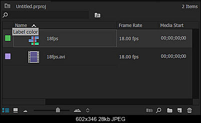

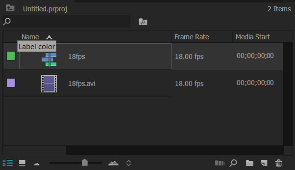

  5. I don't have CS6 easily accessible right now (it's on a disassembled computer), but if you right click a clip and choose "new sequence from clip" it will make the sequence the same characteristics as the source file

    When you export with AME, some options are locked off, but you should be able to get 18 or 16 fps with AVI, let me just check quickly
  6. Yes, it's not a problem - when you load the same PP sequence in AME, just hit the "match sequence settings" check box in AME
    I checked to see if any "weirdness" is going on like changing the framerate, introducing dupes etc..., and they are unique frames - so it all works fine (in CC, I won't be able to check CS6 for a few days)
  7. It might be slightly different in CS6; I think it's File=>new=>sequence from clip, but the match sequence box in AME should still be there

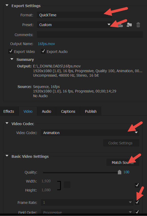

    Save your project. File=>export. When you use AME, there will be presets like NTSC DV - those are SD - that's why you're getting 720x480. Don't use those. Instead click on that hot text. Under "preset" in the export settings, use "custom" which will unlock the other options , or something other than DV
    Same with Codec . Some codecs are limited or have specific resolutions like DV (NTSC DV is always 720x480). Don't use that. Instead pick something else. What I'm trying to say is some options will limit you to specific resolutions and framerates
    In AME there is a "match source" button under the video tab, that will match all the characteristics like dimensions, frame rate etc.. automatically . If you just want to match one characteristic, like frame rate, then there is a box to the right of each entry that will match that characteristic when you have it checkmarked. But not all formats will have the "match soruce" available because they don't support it. For example , if you had it set to NTSC DV, 1920x1080 would be "illegal", that's why the button isn't even an option

  15. Click image for larger version
Name:	custom settings.jpg
    A quick example of what I mean. I put arrows on the categories I changed. A common one that I use is quicktime animation codec (I sometimes do 3d work on other progams and it's interoperable across programs and platforms). But you can use others like cineform, uncompressed , etc... The key point I'm trying to make is if you pick certain formats or codecs - some of them have limitations. For example FLV is usually meant for low quality web distribution, so it might not have the other options unlocked or available to change
    Pay attention to the summary section where it says output and source - you want those to match 1920x1080 16FPS. It did this for me automatcially when I hit the "match source" button under basic video settings. It checkmarked those boxes to the right of categories like frame rate automatically and greyed them out, because they now match the source.
    If you had picked "DV" under video codec, that would again limit your to 720x480 - so you need to pick combinations that are "legal"
