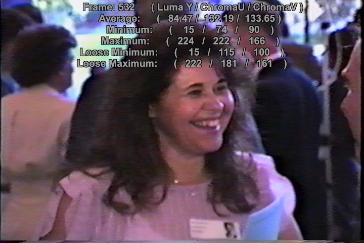

  2. My first bit of advice would be to go back and start over. Don't you have a way to adjust the levels/brightness/contrast? That should always be done before capping. The blacks are crushed and the whites badly blown out.
    The second bit of advice would be to get a line TBC in there somewhere.
    I work on audio using Audacity and rejoin the audio with the video when authoring.
    Using this script:
    AviSource("reunion.avi",False)
    ColorYUV(Analyze=True).Limiter(Show="Luma")
    shows the blacks and whites outside of 16-235.
