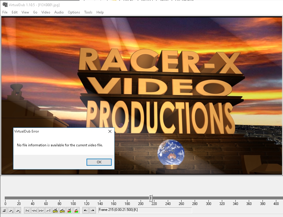

    @ racer-x - when you have it open, use file=>file information to see which "driver" is actually being used
    It uses no "driver", just the default image reader......

  15. @racer - yes that's the default image reader (good)
    If you manually select ffmpeg as the driver from the dropdown menu, or have the priority set - it will open 1 frame only . (The priority option is only available in the last 2 versions) . I made some edits above, but everything works the way I want it to with different formats when it's uncheckmarked
