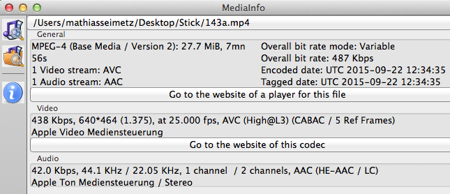

    I actually would just like to copy the file and only correct the aspect ratio, but to me it seems I can only convert to another format, including encoding, if I want to youse the filter, where one can add pxels to the left and right (+8 each?).
    Other ideas?
    Mpgstreamclip will offer to fix the aspect ratio, but only when encoding a second time eventually loosing quality like in Avidemux.

  2. Do you realize that 1.37 is a common aspect ratio for movies? So your file may be fine (only off by a tiny bit) as it is.
    You cannot change the frame size without reencoding.
    You can use a program like My Mp4box GUI to flag the aspect ratio in the header. But not all players will respect the flag.

    Of course it is 1.375:1 I never said it was 3.755:1 ??? (You can also see this in my screenshot of mediainfo above).

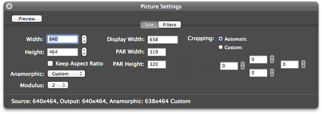

    Hm, in my Handbrake version 0.10.2 there is no DAR, only PAR. I can fill out "PAR width:" and "PAR Height:".
    This is the Picture settings window of Handbrake.(see attachment)

    That was obviously a typo on my part. I meant to type 1.375, not 3.75. And if you do the math you'll see the resize dimensions I gave are correct for 1.375:1. You can do all the resizing and letterboxing in AviDemux. If the program doesn't crash on you before it finishes.
    I have no use for Handbrake. I do all my filtering in AviSynth and all my encoding with the x264 command line encoder.
    Your output from those Handbrake settings will not be DVD compatible. You'll have to go through another resize and another reencode. A waste of time and a further loss of quailty.
