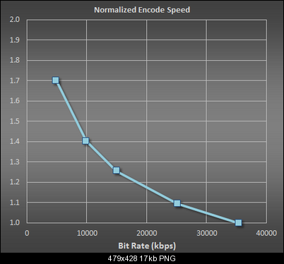

  1. I noticed something rather surprising recently. My encode speeds using x264 seem to be a strong function of the bit rate.
    Most of my encodes are for web delivery that gets re-encoded anyway. Rather than using 2-pass VBR, I prefer 1-pass CBR close to BR specs like 35 Mbps to maximize quality delivered.
    However, I was recently playing around with a project where the only thing I was changing was the CBR of the encode. I encoded it three times: 35 Mbps, 20 Mbps, and 5 Mbps. As the bit rate decreased the fps got increasingly faster. And this was not some minor difference. I didn't write down the speeds, but I want to say that 5 Mbps was like 8x faster than 20 Mbps.
    This surprises me because I assumed, naïvely of course, that an encoder has to work harder at low bit rates versus high bit rates. Does anyone have any thoughts on this? Thanks.

    You may imagine this like progressive quality: The encoder will start with a rather coarse quantization, and if the result does not yet exceed a bitrate or rate factor limit, it will try again with a finer quantization ... and again ... very simplified. I hope a developer can explain this a little better but still descriptive enough.

  10. More bitrate = more data for CABAC to compress.
    Btw, for maximum quality over network use --vbv-maxrate and --vbv-bufsize 2-pass encoding. Maxrate at 35000 and buffer size of 35000 (1 sec) or 70000 (2 secunds) should do the trick. You could even reduce bitrate a bit to save bandwidth.

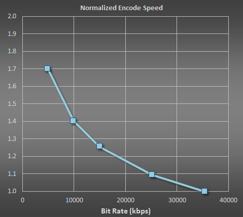

  11. I am not sure how rigorous this test is. But I decided to encode a 15 sec clip from my project and see how the speed varies as a function of the bit rate. This is the x264 code I used:
    x264.exe --bitrate XXXXX --preset slow --level 4.1 --ref 4 --tune grain --crf 17 --vbv-maxrate XXXXX --vbv-bufsize XXXXX -o "video.264" "signpost.avs"
    Below is a plot of the encoding speed as a function of the bit rate normalized on XXXXX = 35000 kbps. Thus, for XXXXX = 5000 the encode speed is 1.7x faster than XXXXX = 35000. Probably should have left out the --crf flag. But when I removed it for the XXXXX = 5000 test, it sped up by only 2%.
    Anyway, I am glad I figured this out. I didn't realize this was a way to speed up my encodes. Every little trick in the book helps
