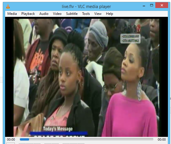

  3. That site provides an alternative hls stream which you can capture with livestreamer.
    livestreamer "hlsvariant://http://live-19.viewer.dacast.com/i/dclive_1@192860/master.m3u8?hdnea=st=1442872366~exp=1442872486~acl=/i/dclive_1@192860*~hmac=52312cef8d628bc8b08e2b07eceffa142b0d6f353a12ffb3425f28a0976f515e&hdcore=3.6" best -o live.flv
    The bit in red is the code you will have to find each time yourself by using something like HttpFox and searching for "m3u8" (without the quotes).

    Thank you very much for this alternative
    I am currently busy in testing it...

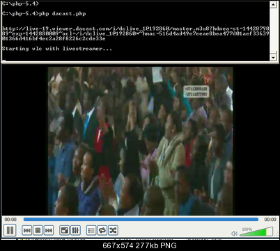

    I finally managed to try your method, it works very well too
  12. Yes, thanks once again biezom. I have HDS link detector/php etc. I just made a trivial error in its use.
  13. Originally Posted by Moet View Post
    what is the version?
    php -v
    did you have Download PHP.ini and copy it to the same folder?

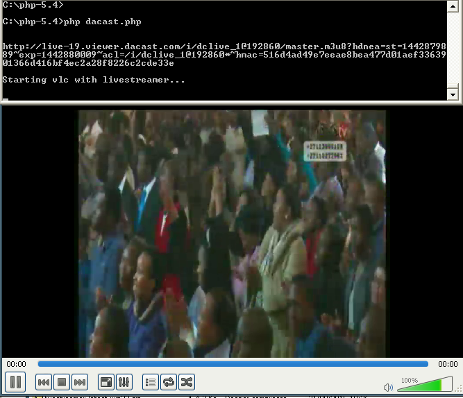

    i write a php code to run the stream with livestreamer automatically
    <?php
    $hls=file_get_contents('http://json.dacast.com/b/51788/c/69350');
    $m3u81b= strpos($hls, '"hls":"'); $m3u81e=  strripos($hls, '"}'); $m3u81f = $m3u81e - $m3u81b ;
    $m3u81= substr($hls, $m3u81b , $m3u81f); $m3u82=str_replace('\\',"",$m3u81); $m3u83=str_replace('"hls":"',"",$m3u82);
    $pretoken= file_get_contents("https://services.dacast.com/token/i/b/51788/c/69350?");
    $pretokenb= strpos($pretoken, '?hdnea'); $pretokene=  strripos($pretoken, '","expiration'); $pretokenf = $pretokene - $pretokenb ;
    $token1= substr($pretoken, $pretokenb , $pretokenf); $token=str_replace('\\',"",$token1);
    echo "\n\n";
    $m3u8= $m3u83 .$token;
    echo "$m3u8\n\n";
    $hlsvariant=str_replace('http',"hlsvariant://http",$m3u8);
    echo "Starting vlc with livestreamer...\n\n";
    	echo shell_exec("livestreamer  \"$hlsvariant\" best  &");
    	echo "Done.\n";

    GREAT!!!
