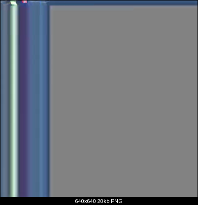

  1. Hi
    I'm encoding this video:
    Guessed Channel Layout for  Input Stream #0.1 : stereo
    Input #0, avi, from 'input.avi':
      Duration: 00:00:15.00, start: 0.000000, bitrate: 841360 kb/s
        Stream #0:0: Video: rawvideo, bgr24, 1080x1080, 841678 kb/s, 30 fps, 30 tbr, 30 tbn, 30 tbc
        Stream #0:1: Audio: pcm_s16le ([1][0][0][0] / 0x0001), 48000 Hz, 2 channels, s16, 1536 kb/s
    using the ffmpeg command:
    ffmpeg -i input.avi -codec:v libx264 -profile:v baseline -preset slow -pix_fmt yuv420p -r 29.97 -b:v 25000k -threads 0 -acodec libvo_aacenc -ar 44100 output.mp4
    This produces the following video:
    Input #0, mov,mp4,m4a,3gp,3g2,mj2, from 'output.mp4':
      Metadata:
        major_brand     : isom
        minor_version   : 512
        compatible_brands: isomiso2avc1mp41
        encoder         : Lavf57.2.100
      Duration: 00:00:15.04, start: 0.036281, bitrate: 24893 kb/s
        Stream #0:0(und): Video: h264 (Constrained Baseline) (avc1 / 0x31637661), yuv420p, 1080x1080, 24794 kb/s, 29.97 fps, 29.97 tbr, 11988 tbn, 59.94 tbc (default)
        Metadata:
          handler_name    : VideoHandler
        Stream #0:1(und): Audio: aac (LC) (mp4a / 0x6134706D), 44100 Hz, stereo, fltp, 128 kb/s (default)
        Metadata:
          handler_name    : SoundHandler
    There are no artefacts at this point, but when I upload this mp4 to instagram, I get the following artefact:
    See for yourself at https://instagram.com/p/73mZSGTCqz/
    What could cause such a monstrosity? Any ideas on how to get a better result?

  4. Isn't the max resolution 640x640?
    Try disabling weightp - a similar decoding error used to happen to other websites
    In ffmpeg libx264 it would be
    -x264opts weightp=0
