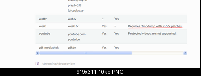

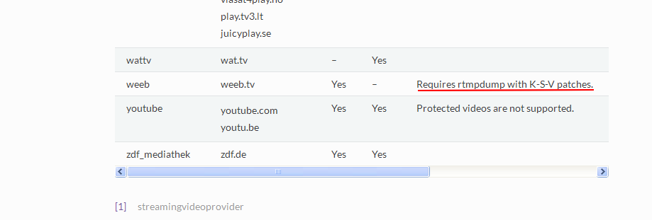

  5. http://docs.livestreamer.io/plugin_matrix.html
    https://github.com/K-S-V/Scripts/releases/download/v2.4/rtmpdump-2.4.zip
    this version incude --weeb|-J string Authentication token for weeb.tv servers

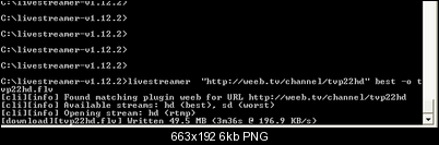

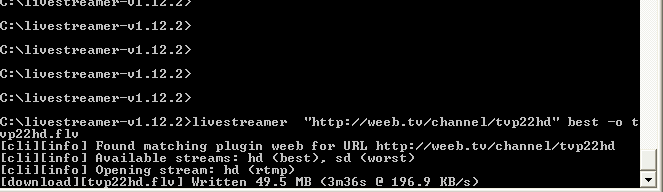

    livestreamer  "http://weeb.tv/channel/tvp22hd" best -o tvp22hd.flv
  6. And of course it works perfectly when piped to VLC ... thank you once again biezom
