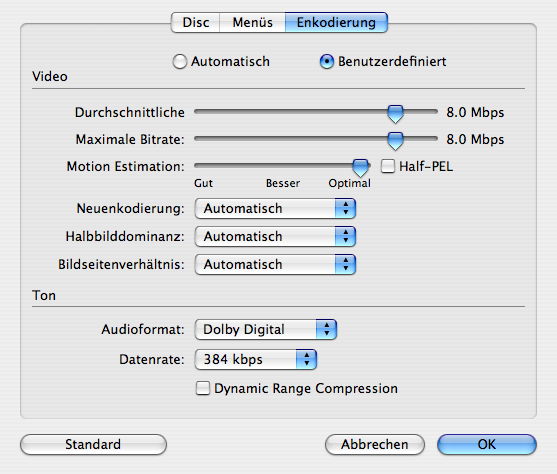

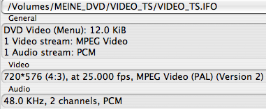

    iDVD:
    - through any file (xvid.avi, DV-avi, h.264,mov, mpeg4.mp4,...) in the first window of the menue.
    - click burn. Nothing to select! (instead I didn't burn, I saved an image)
    - the Application is encoding
    - result, it doesn't give you options, it just say, this is what I choose for you and it is PAL-DVD compliant (see picture, mind I use a iDVD5, which is from arround 2004/5 so, newer once might have newer settings and better compression etc.).

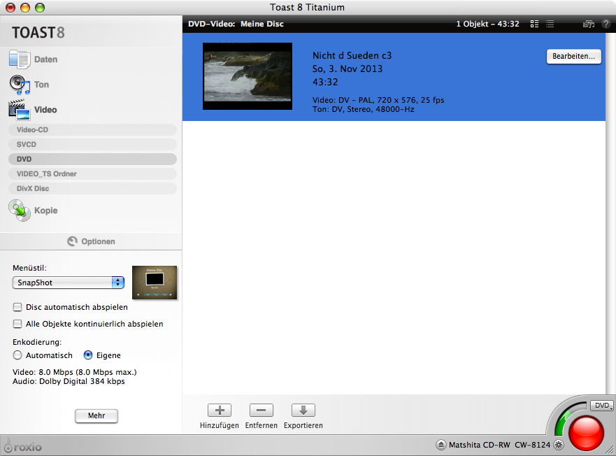

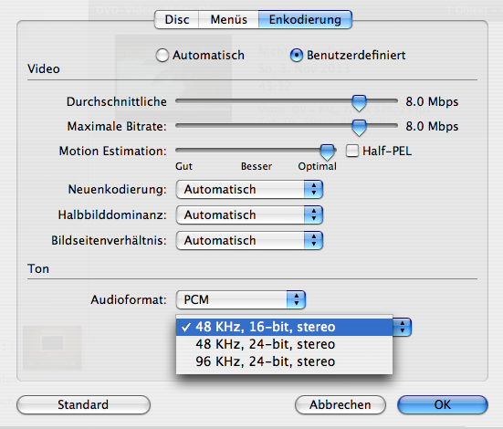

    Toast
    - you choose what kind of media you want to burn (Data, disc, audio-CD, SVCD, VDVD, DVD, copy, Image,...)
    - you choose DVD and hit "options"
    - you are only presented what is compliant with PAL-DVD. You can choose the bitrates, and if you like PCM or AC3 (see the other pictures).
