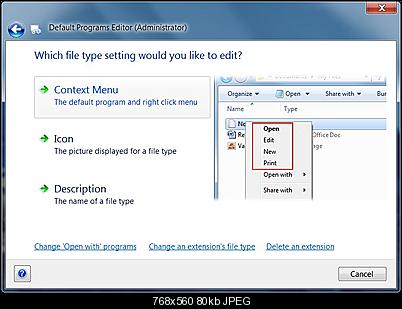

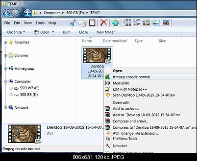

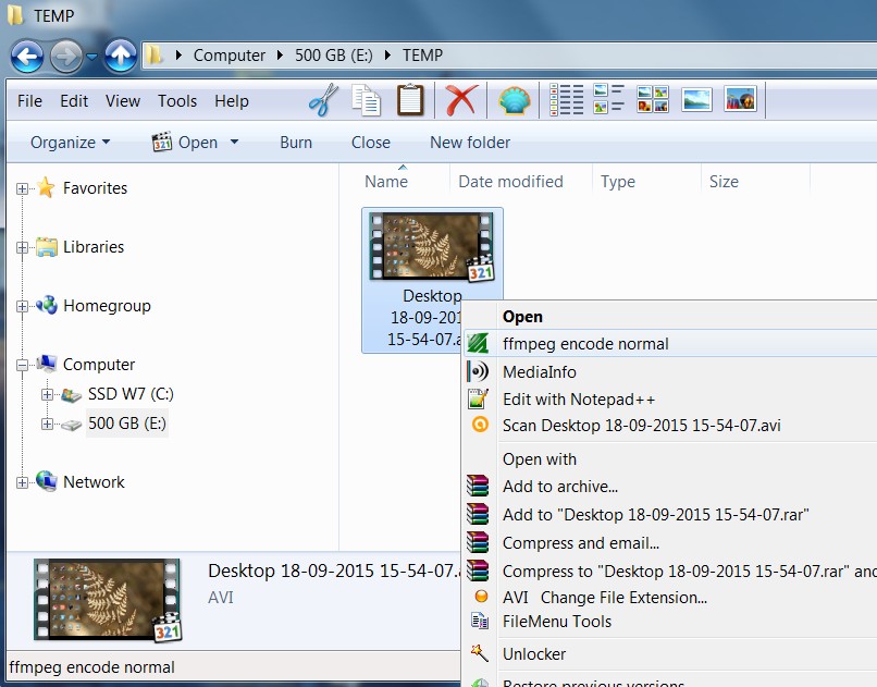

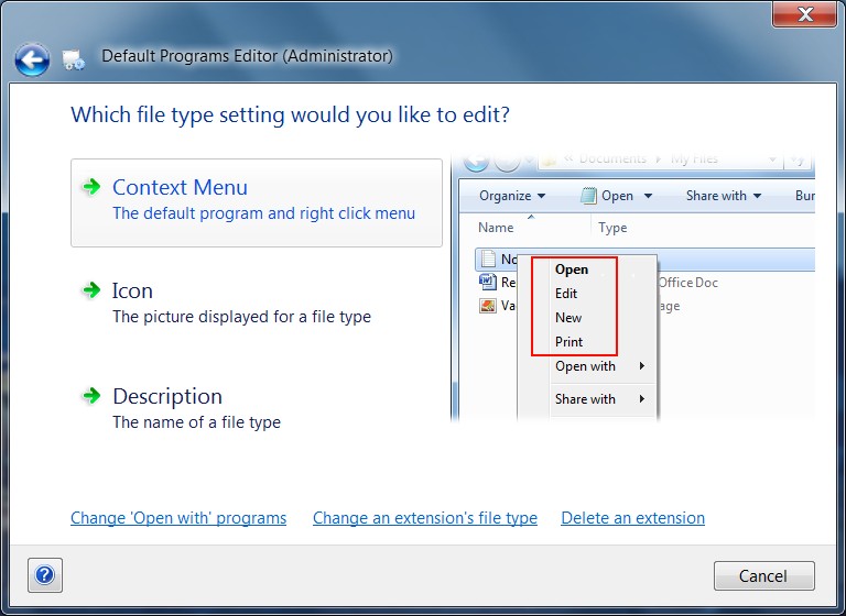

  3. You can also add custom context menu on right click for ffmpeg or HandBrakeCLI (handbrake command line)
    with Default Program Editor:

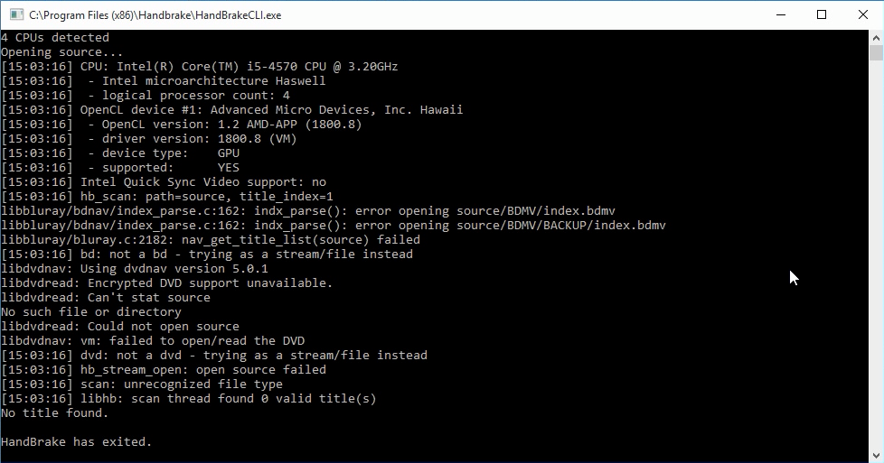

  4. Lone soldier Cauptain's Avatar
    Jan 2006
    Brazil
    Guys,
    I mix the 2 solutions. script by Jagabo and right click for roma_turok. The command line screen open and close.
    Wheres my fault? I download FFMPEG from here - 32bits, extract to folder, copy the jagabo source, only change ffmpeg patch. Nothing.
    Try with mp4 and avi files. I dont know handbrake cml.
    Claudio

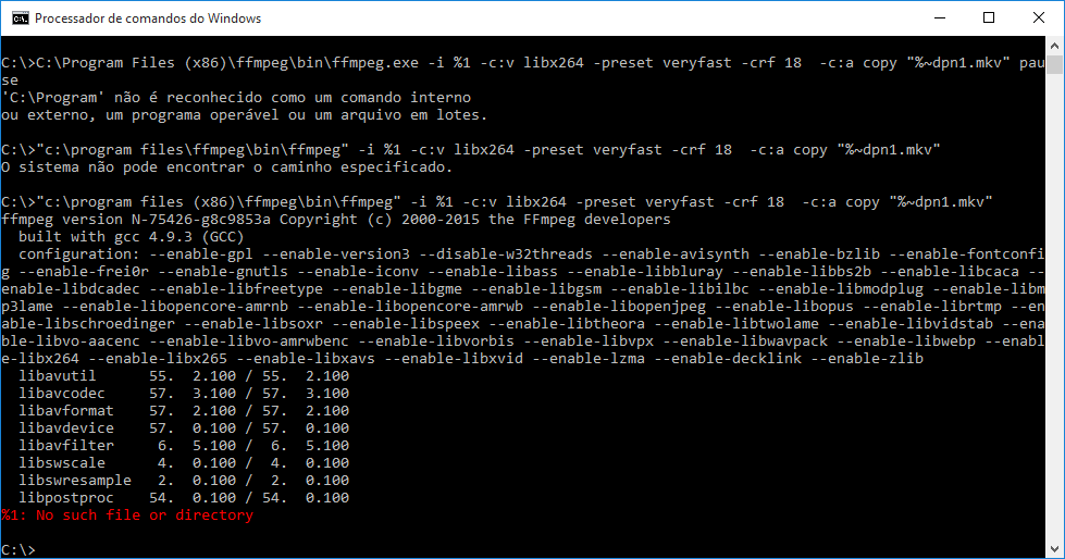

  5. Add "pause" (without the quotes) to the end of the script and it will keep command line window open. Then copy & paste the error message or what it says back here
  6. Lone soldier Cauptain's Avatar
    Jan 2006
    Brazil
    Using PAUSE not work for me if using with DEFAULT EDITOR. The screen open/close only.
    Open CMD and run, its give me the screens below:
    PS: Jagabo script drag drop works perfect!!
    Claudio

  9. The container is specified by the output file extension. So just change it from .MKV to .MP4. Since the command doesn't reencode the audio be sure the source audio is valid for MP4.
    In your earlier failed run in post #6 you didn't have quotes around the ffmpeg filename spec. So it interpreted "C:\Program" as the program to run, not "C:\Program Files (x86)\ffmpge\bin\ffmpeg". File names with spaces in them require quotes around them, otherwise the spaces act as delimiters.

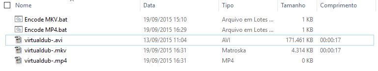

    Interleave, preload duratio : 33 ms
    I change to MP4 but not work. Its give me 0kb file. MKV script works ok
    I need a script to any video file to MP4.
    Claudio
