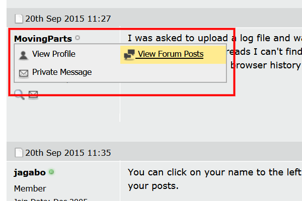

  11. I was asked to upload a log file and was given a link, where I could temporarily upload it unfortunaely, when I go through my recent threads I can't find the thread where I was asked for it. Can someone name me the upload page, so I can search that in my browser history and find the thread via that one?
  12. You can click on your name to the left of any of your posts and select "view forum posts". That will give you a list of all your posts.

  13. Thanks, I know, that is what I did. I first searched all threds started by myself and then all posts, but couldn't find it. Then I posted, if someone could help me find it. BUt I have maken a very stupid mistake! It was in the HAndbrake-Forum, not in this. This explains, why I couldn't find it here. sorry.
