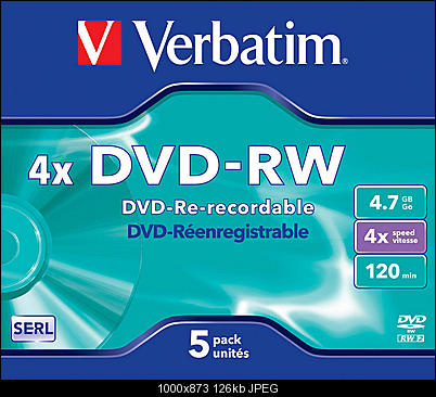

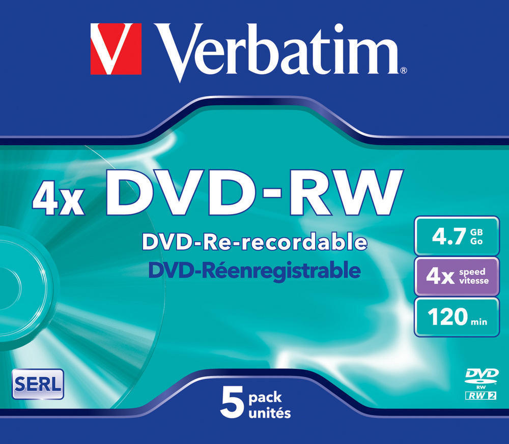

    I Have a Jvc DR-MV150B DVD/VHS VIDEO RECORDER Combo..I Have Been Recording on Dvd-r TDK Brand Disc and have had no problems..I recently purchased Verbatim DVD-RW 4x SERL .Verbatim is recommended by JVC as a compatible disc...When i inserted the disc it was unable to read any of them. However i can insert it in my Pc and It recognizes it right away.. My unit was made in 2009 . Im not sure if i bought the right disc..Im a newbie to this... Please Help..ThanksClick image for larger version

    Your manual should tell you what disks are compatable.
    It is not the brand that matters but the speed of the disk. Many recorders will baulk at disks over 2x. Even disks rated 1-4x can fail. I know since my Sony refuses to record on such disks even though the manual will state 2x. With my recorder I found Sony Disks 2x/1x do work. But I tried many others and just got lucky with these.

    Those disks might well have worked back when that manual (you said 2009) was published.
    The other issue is that disk dyes have changed. Even manufacturers - most of these brands do not make their own disks - have changed. It really comes down to trial and error.

    A recorder getting picky with discs(when it never did before) is a sign that it is on it's way out......usually. Get your pending recordings done soon.

    Verbatim DVD-RW is good media and the manufacturer hasn't changed it much (if at all) for years. It should work with most DVD recorders, especially if it is recommended by the manufacturer.
    Even if your DVD recorder wasn't used often, the DVD drive may still be starting to fail. Even withing the same model, some drives die much sooner than others.

    Is there another brand of disc you would recomend trying and should i try a 2x instead of 4x?
  10. The "media recommendations" in most recorder manuals are dubious: the list in yours is meaningless (just a list of every brand on the market at the time). As others have advised you, ignore the manual and stick to what actually works for you.
    Standalone recorders are strange persnickety beasts: they like what media they like, and nothing else. This gets to be a problem as they age, because blank media is not static: the formulas change, speed ratings change, brand names change owners, brands decide to subcontract to other mfrs instead of making their own, etc. So if your recorder consistently fails with a particular type or speed of blank from a particular brand, cross it off your personal list. Your JVC clearly doesn't like these newer Verbatim 4x RWs, so get a refund on them (if you still can) and go back to whatever slower discs you were buying previously. You may need to order them from web dealers now: retail stores stock very limited range of brands and speeds. It is hard to recommend a brand for RW because RW changes production constantly. For -R or +R, any Verbatim with the AZO trademark is known-good, and 8x JVC/TY -R is excellent. Everything else is a roll of the dice today: mfrs could care less if it works or not in a recorder, since recorders are "obsolete" as a mass-market product.
    Also keep in mind what hech54 said: increased pickyness with media is often a sign the unit is beginning to fail. Your JVC DRMV-150B is closing in on six years old: that is roughly the max lifespan for most of them before they croak. Try other media until you find some that works, then finish whatever VHS dubs you have left to do ASAP. Don't let unfinalized DVD-R, +R or -RW pile up: if the recorder dies suddenly, you'll be left with a stack of unplayable discs. One of the most frequent thread topics is "my recorder died: how can I finalize my discs?" - don't let this happen to you, finalize full discs promptly. If you prefer RW erasable discs, +RW might be better since it doesn't need to be finalized like -RW, -R and +R (+RW should be compatible with most players as-is).

    You can't use 4x DVD-RW in this recorder.
    You need to use 16x DVD-R pr 2x DVD-RW.
    It's not dying.

    One of the top thread subjects on several dvd recorder forums for the past two years has been "My JVC DRM-V150BB (or LG twin) is dead and nothing at all like it is available to buy new anymore: what can I do to finalize my 400 half-recorded dvds?" Thats not a slam against the JVC 150: before that it was "My Panasonic Model X" and before that "My Pioneer Model X," its just now become the JVC 150s turn (as the last "hot" model made). DVD recorders fade after 5-6 years consumer use: its the norm. Some are lucky and get eight or nine years, but those were older more-repairable models like your JVC DRM100 (that you have invested some effort in maintaining, beyond what the typical consumer might do).
    itsjstkim, your recorder is probably OK at the moment, it just works more reliably with some blanks than others. But it is getting older and irreplaceable, so its still a good idea to keep track of unfinalized discs and not let too many accumulate. Never hurts to have a good workflow.

    Most of the DVD-RW media available is 4X.
    Verbatim's website only lists single DVD-RW 2X discs in a jewel case. I found that product at Walmart's website and B&H Photo and Video's website. Very few places are selling Verbatim DVD-RW 2X in larger quantities, which I guess is old stock.
    Other than that, I found Sony: http://www.bhphotovideo.com/c/product/1013926-REG/sony_25dmw47spm_dvd_rw_4_7gb_recordable_media.html
    ...and Maxell http://www.bhphotovideo.com/c/product/509951-REG/Maxell_635117_DVD_RW_4_7GB_DVD_Disc.html
    Verbatim 2X lasted longer for me and was more reliable than either Sony or Maxell. Most of my DVD-RW 2X disks are an Office Depot product that is no longer available.
