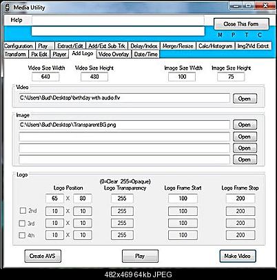

    FFMpeg in conjunction with AVISynth works best for me. You can set the transparency to whatever you would like.
    First decide what you want and where:
    Then create your avisynth corresponding to those settings:

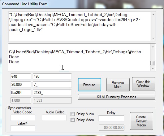

    Then create with FFMpeg:

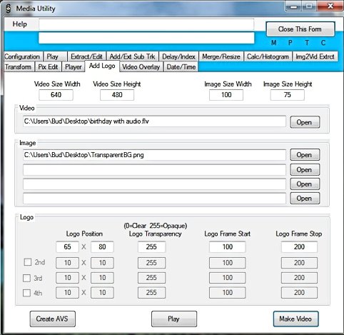

    AVISynth makes it possible to add more than one logo and you can have it show easily in a set number of frames
