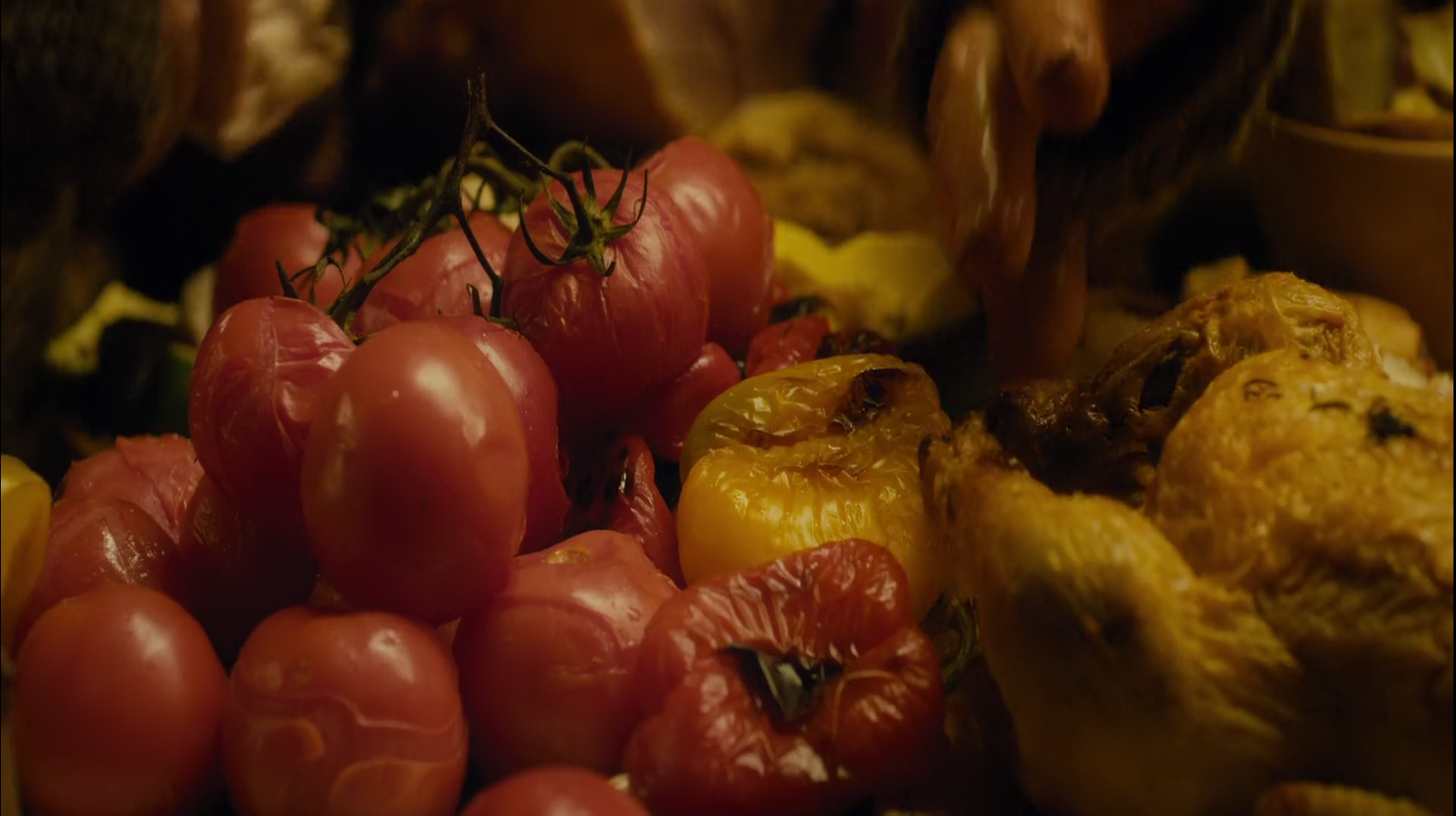

    I have recently started using MadVr in conjunction with Potplayer. My decision was prompted by some nice features in Potplayer that I preferred to my old player (VLC) and what I read about MadVR being the best video renderer out there.
    What I have noticed is that the saturation of reds leaves something to be desired with a tendency for them to be on the orange side. This also affects skin tones which can look unnatural.
    I decided to try the other video renderers available in Potplayer and found that although some gave very similar, if not the same colours as MadVr (both the VMR 9 options did this) others gave colours that seem identical to VLC with much truer reds and good skin tones. (Both the VMR 7 options and Built in Direct 3D9 )
    I went with the Built in Direct 3D9 renderer but I confess that it was not a choice made on the foundation of any knowledge but by the fact that the colours are great and the video plays well and I don't notice any artifacts.
    I wonder if anyone has any experience of the problem I had and can give any guidance as to how best overcome it?

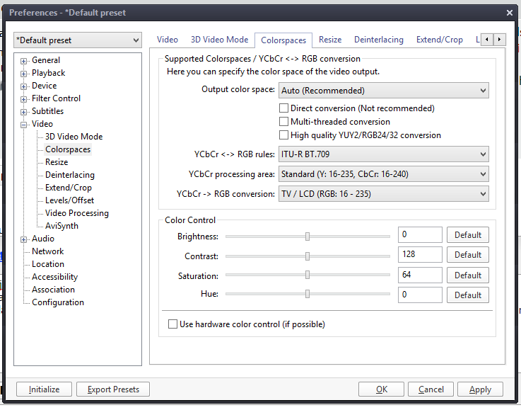

    I play HD videos from my full HD computer to my Full HD TV and so I set the YbCr <-> RGB Rules to rec.709. Please see my attachment. Have I set things correctly and is there anything else I should do ?

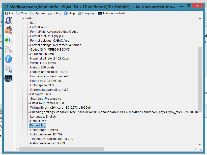

    It sounds like your HD videos are rec.601. Check them with MediaInfo.

    I did as you suggested and checked out a file exhibiting the behavior and it comes up as 1920 X800.

  6. If it is a rgb (lossless) video, there is an issue. If you leave a sample to compare, I'll try it and let you know the result. Recently I'm testing something like that and collect samples.
    Other than this, use a default setting (let the player decide YCbCr <-> RGB conversion method).

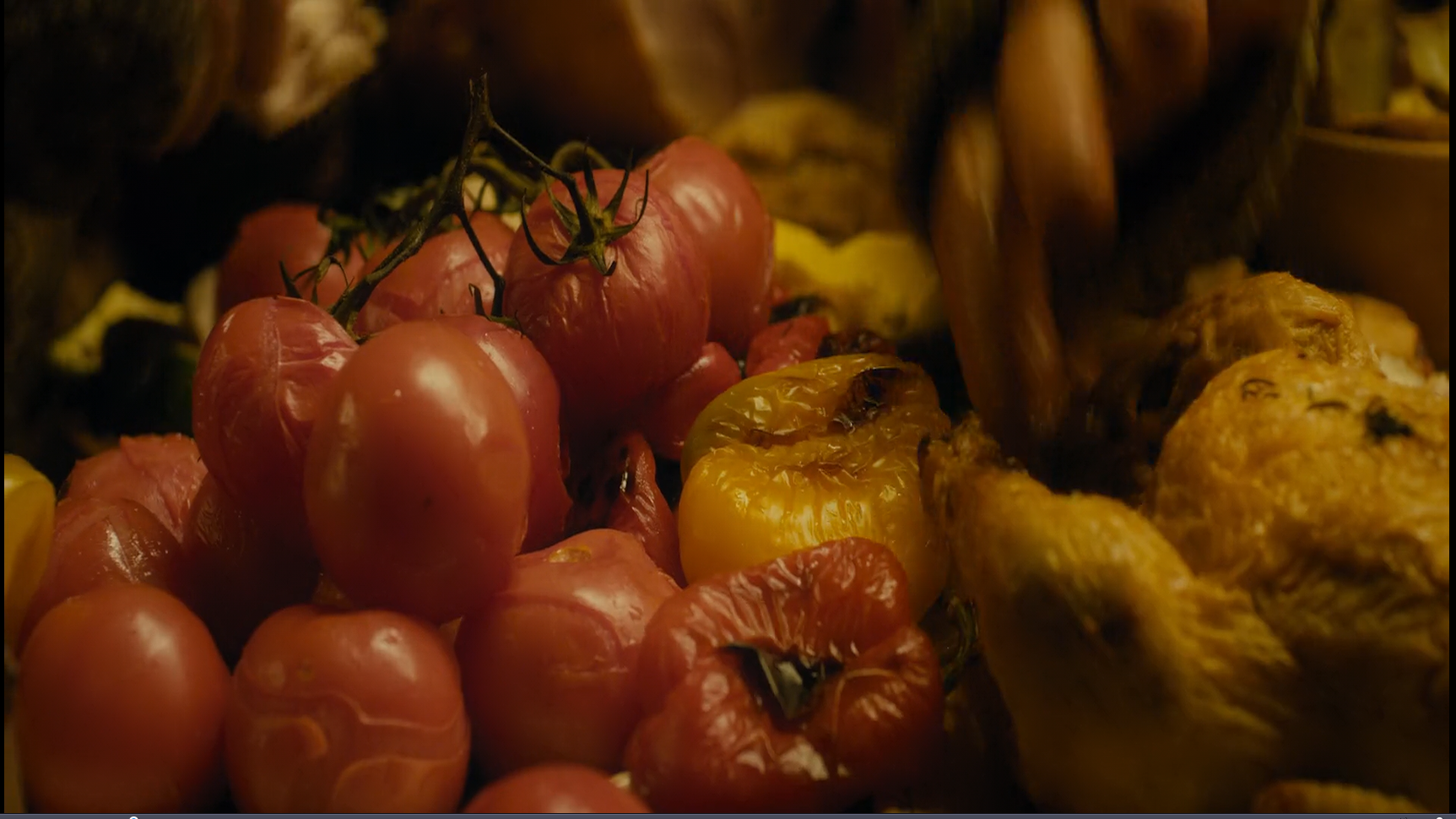

    Hi sheppal I have set the conversion method to auto as suggested and have uploaded some images. Oddly when I view those images on the forum the colours appear identical although on my TV and on my PC screen the MadVR one displays a very obvious undersaturated red in comparison to the Built in 3D9 renderer and also VLC. Both of which look identical.
    I have also uploaded a shot of the video info.

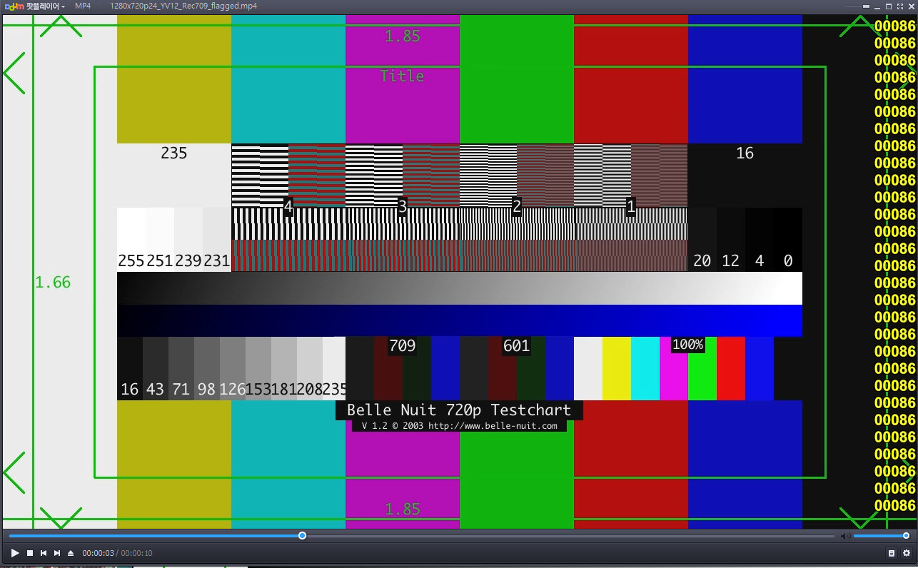

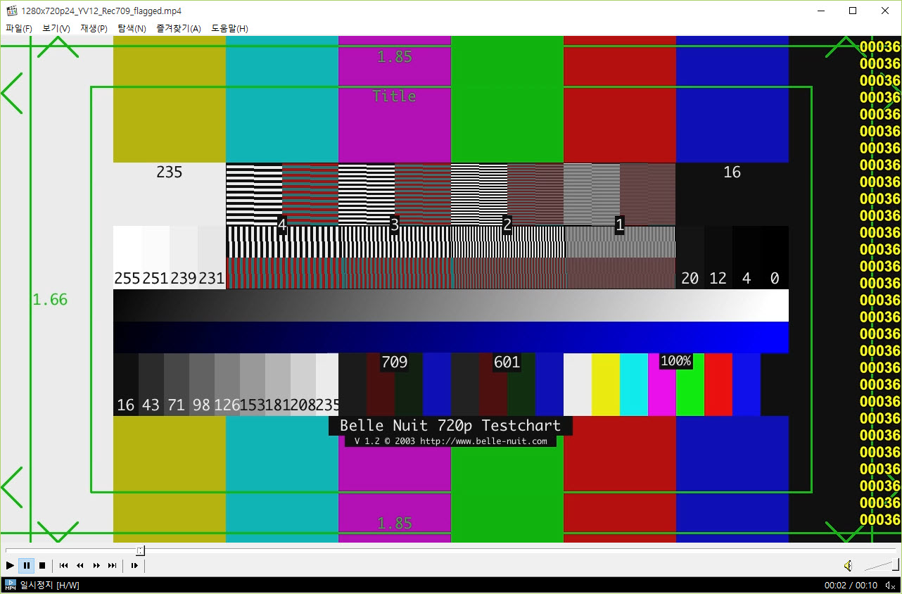

  12. "Undersaturated" doesn't necessarily mean "incorrect". It might have been intended to be that way. You can alter the original image with postprocessing options on playback.
    Here is a known test video , properly flagged, attached below. When you play it in a media player, if the YUV=>RGB conversion is done correctly, it should look like the attached image in terms of colors. For example the red bar should be 180,16,16 for R,G,B values. Because of rounding errors, 8bit precision - you might end up with slightly different values like 180,16,15 etc... but it should be close
    When you are testing, only use 1 instance of a video application at a time. Because most renderers can only use 1 instance. So you might actually be testing something else entirely
    Check the filter chain (I think it's CTRL+F1 in potplayer) and check what is actually being used for source/decoder/renderer

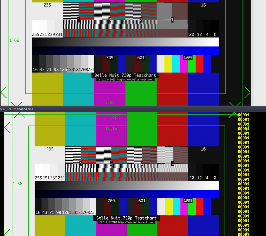

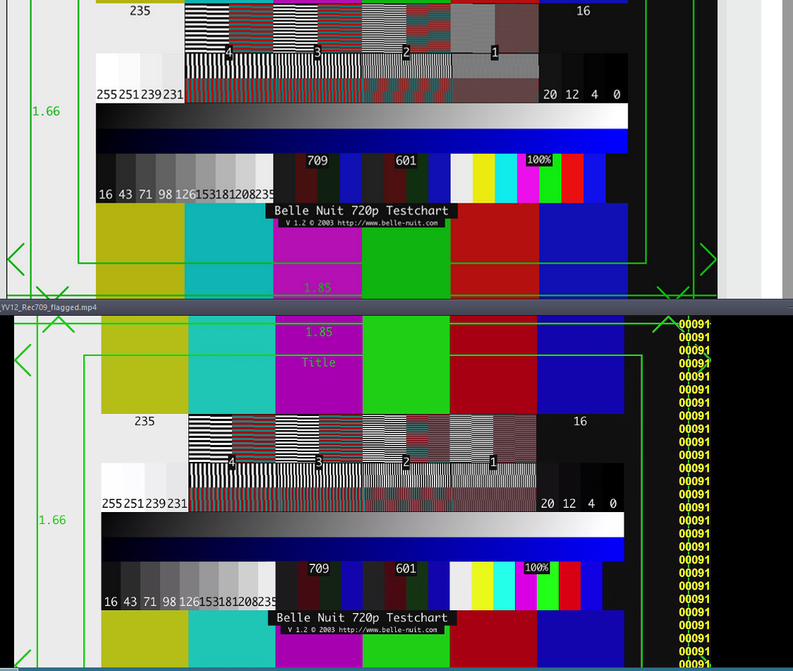

    Jul 2015
    England
    Hi poisondeathray,
    Thanks for the image.
    I have run the file in Potplayer and can see a very slight deepening of the red and a very slight lightening of the green in comparison to your picture on the forum.
    Using MadVR seems to give a more similar result to the forum picture, but I don't know what this means.

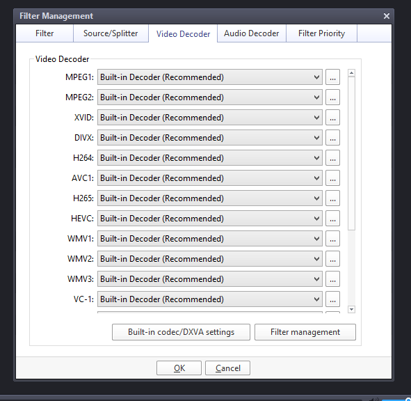

    What is helping to confuse me is that recently I have tried SM player and MPHC, both of which gave the same colours as Potplayer using the In Built Direct 3D9 and VLC. When I tried KMPlayer with MadVR it gave the same colours as Potplayer. This didn't surprise me too much due to the links between the two.
    The images of the file you sent me have been laid on top of the image on the forum for easier comparison.
    I also include info on the filters and hope it is what you wanted.
    Regards Alex.

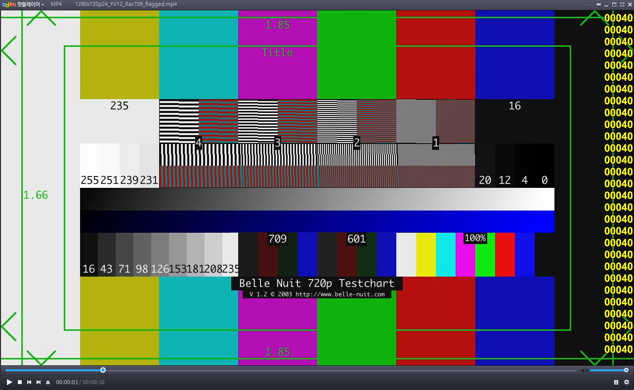

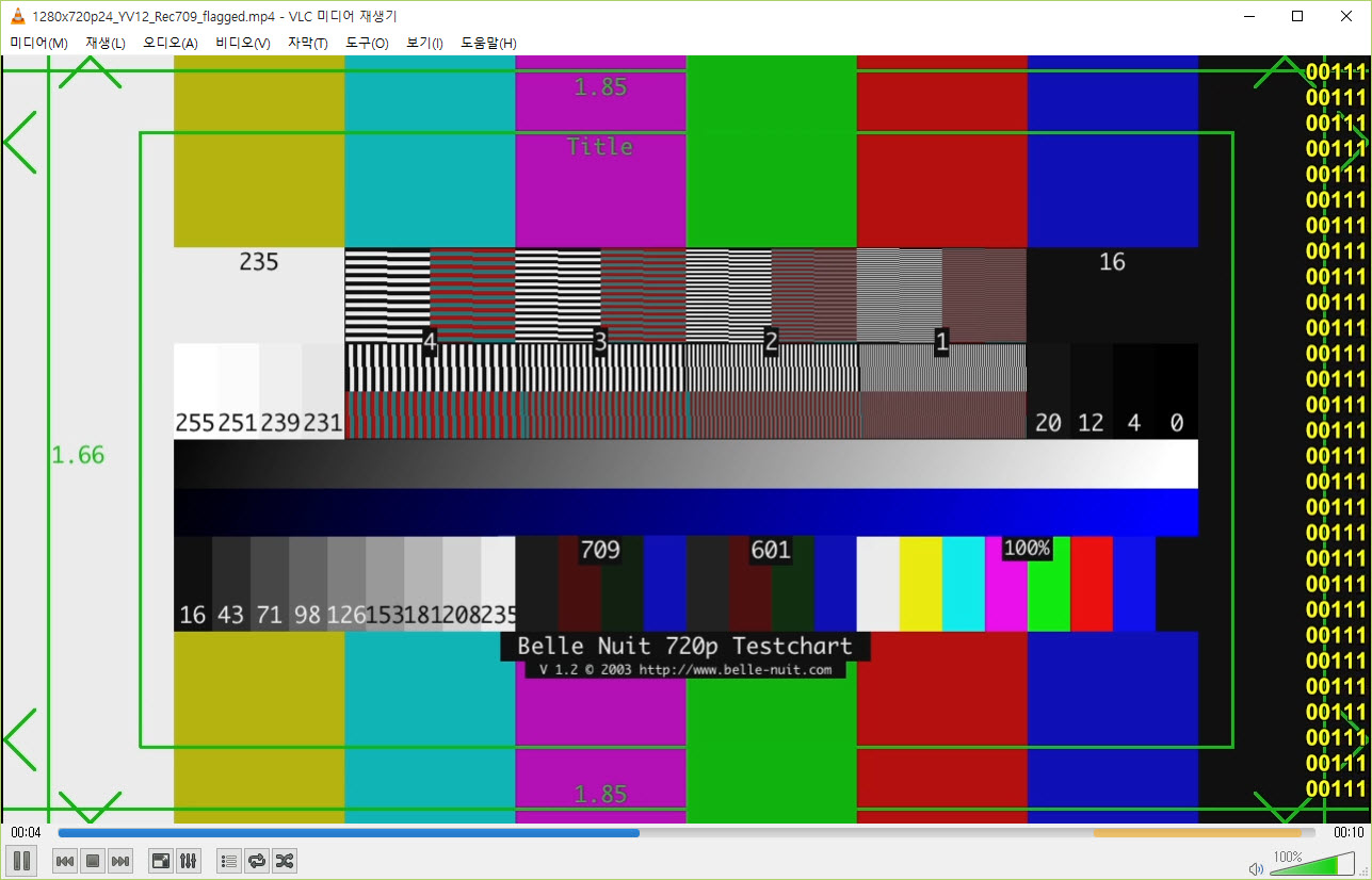

  17. Strangely, I got the same result with both potplayer and others. There seems to be a problem in your setup. I'm using EVR-CP as a video renderer and the potplayer version is 1.6.56273 (released in today). I'm using dxva2 dx11 copyback decoder (iGPU's dxva decoder supporting headless decoding).
    potplayer with EVR-CP
    mpc-hc
    vlc
    potplayer with madVR
    potplayer with built-in D3D9 video renderer
    potplayer with built-in OpenGL video renderer

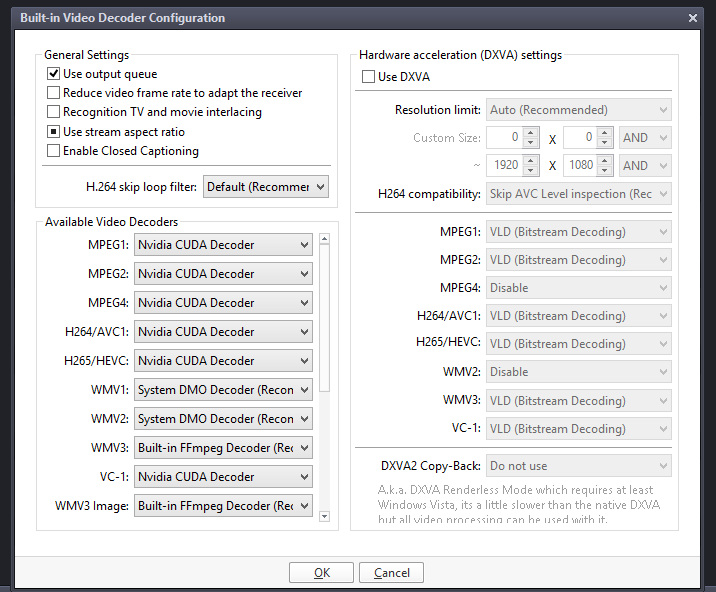

  21. When you show the configuration setup screens, it doesn't necessarily mean those are actually being used in that instance for that video
    While a video is playing, then push CTRL+F1 (or right click=> playback / system info)
    I would argue that getting color accuracy (or at least close) is more important than getting it looking a certain subjective way that you want it to look (you can apply post processing during playback to make it look however you want)

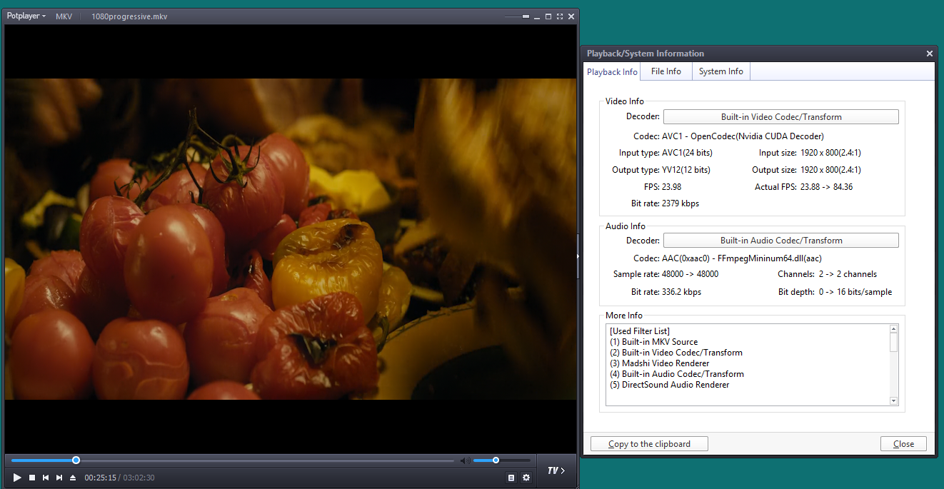

  22. Member
    Jul 2015
    England
    Sorry , I didn't know that . I hope the attached image is what you mean. I'm not at all well clued up regarding video so am learning all the time from your input.
    I do agree that colour fidelity is very important, especially on faces . If a car or a sunset is slightly off hue it may not be so obvious but faces can look unreal if wrong, even given that there are so many natural skin tones.

  23. Originally Posted by alex30 View Post
    If your screenshots were labelled correctly, MadVR is doing it correctly. Notice it matches the source more closely. That is the purpose for using a known test video. (red should be red, green should be green etc...) . The brighter "neon" green and duller red in the screenshot with the 3D9 is classic 709/601 mismatch. I can't explain the other players, they might be configured differently
    Directors and colorists might grade something to look different, or subjectively look different. And/Or your "source" might have been screwed up. Again, color accuracy is important - you can change it to look the way you want it to look, which might be different than the director or colorists envisioned it.
    Directors and colorists might grade something to look different, or subjectively look different. And/Or your "source" might have been screwed up. Again, color accuracy is important - you can change it to look the way you want it to look, which might be different than the director or colorists envisioned it.[/QUOTE]
    Hi poisondeathray,
    Many thanks for that. I am a bit confused as to what exactly is going on but your confirmation that MadVR is rendering the colours correctly is good enough for me and that is what I will go with.
    Thanks for your time and effort, it is very much appreciated.
    Regards Alex.
