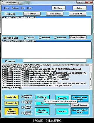

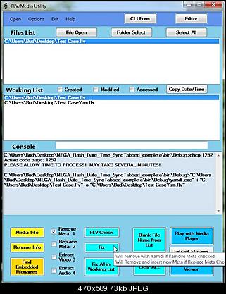

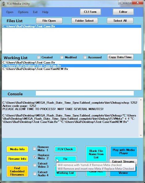

    These all sound like problems encountered with most downloads of FLV's. Normally just removing the Metadata, including timings and replacing it fixes it.
    I use FLVMeta to check the video:
    flvmeta.exe -C "C:\path to video\corrupt.flv"

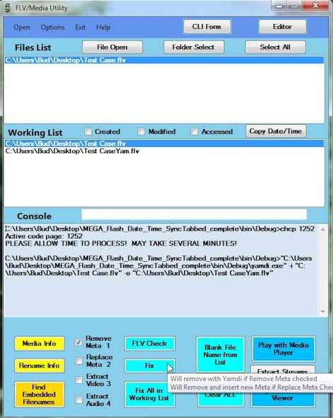

    To remove Metadata I use Yandi:
    "C:\path to Yamdi\yamdi.exe" -i "C:\path to video\corrupt.flv" -o "C:\path to video\corruptYam.flv" -M
    Then reinsert it FLVMeta again:
    "C:\Path to FLVMeta\FLVMeta.exe" -t -f "C:\path to video\corruptyam.flv" "C:\path to video\corruptyamNEW.flv"
    Typical below:
ID:	33682 Initial check
ID:	33684 Remove Meta
ID:	33683 Replace Meta
ID:	33681 Final Check

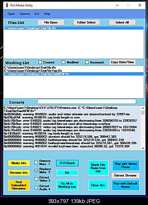

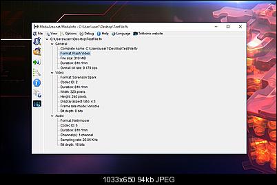

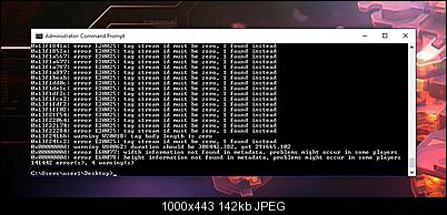

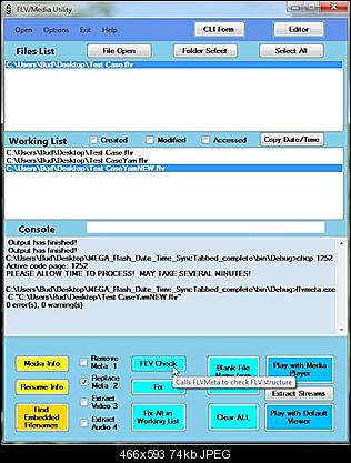

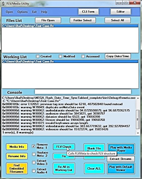

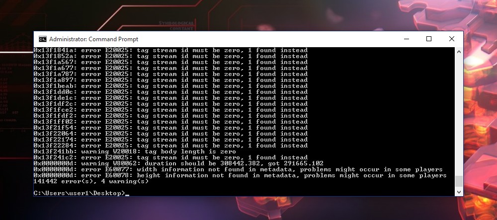

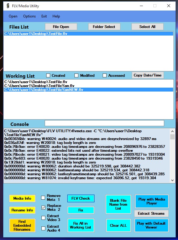

  4. Ok so out of 6 videos I did get 3 of them to work with FLV Extract. Do only downside was there is no sound, which I am fine with for now. The last 3 all failed using FLV Extract and the MKV tools, these had generally the same name and were created about the same time so the method of creating them might have been different though they still have the same exact issues.

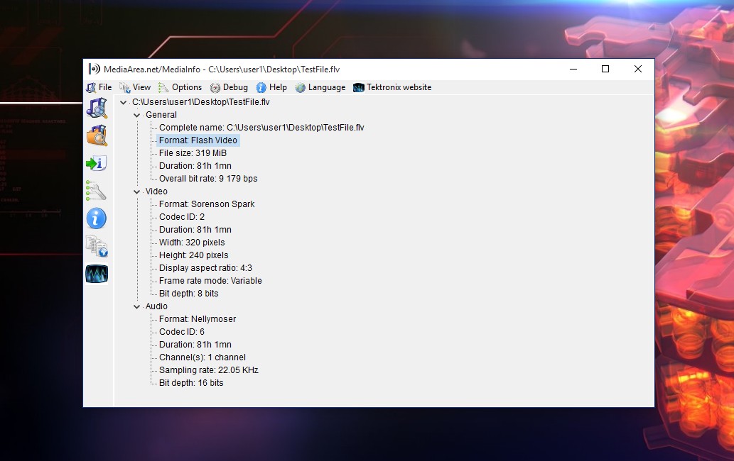

    For these I tried Budman1's command lines and Utility program. The initial check of the video as shown in picture one crashed the Utility, I'll post a screenshot of the cmd prompt running flvmeta on the video and the errors shown. The remaining steps I was able to complete yet the end resulting video was basically just like the original, long timestamp ect.. I'll put a screenshot of the end result shown by the Utility and also the MediaInfo of the original video. Also the last warning from the Utility, the one about the "Invalid Keyframe" basically repeats itself with varying keyframes, but it is the last warning shown. Responses would be great, thanks.
Name:	FLVmeta - Test.jpg
ID:	33687 Click image for larger version
Name:	Utility - Test.jpg
ID:	33690Click image for larger version
Name:	MediaInfo - Test.jpg

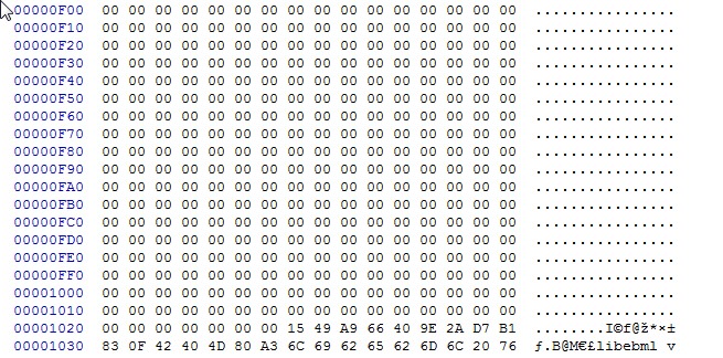

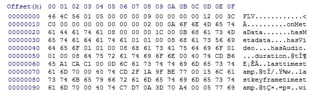

    With all the ID errors and tag body length error, that looks like a captured streaming video that took some hits during capture? Sorenson Spark are usually easier to fix than AVC but it takes a hex editor like HxD to fix and most times chunks will be missing due to the wrong ID, multiple bytes of hex '00' and/or invalid frames removal.
    If I do the math right, 319 MBytes X 8 bits in a byte = 2,552,000,000 bits divided by 9179 bit rate = 278025 seconds divided by 3600 seconds in hour = 77.229 hours. Pretty close to 81 hours. I'm betting there is a lot of hex '00' nulls in that video.
    I see the Height and width is missing also and they are usually inserted by replacing metadata. You did replace metadata on the result of removal (Videoyam) and not original right? Just wondering.

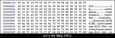

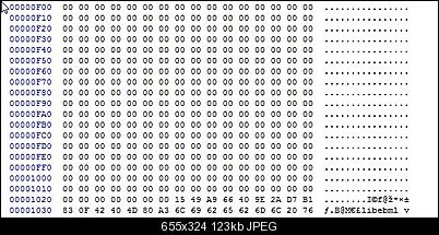

    You don't have a way to post that video do you? Or look at it with a hex editor. The first 17 hex bytes are important especially 00-05, 08 and 0D. OD may be 09 (Video) or 12 (Metadata). Also look thru and see if a lot of it is nulls (hex 00) in a row.
Name:	ScreenHunter_165 Sep. 15 22.36.jpg
Name:	ScreenHunter_165 Sep. 15 22.42.jpg
