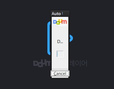

  8. I have the same problem. Worse, when I say to go ahead and update I get a tiny window with one box and "cancel" the only thing that works.

  9. Originally Posted by Bliznoo View Post
    [Attachment 33705 - Click to enlarge]
    Problem solved. I simply downloaded the installation file (64 bit) and did the normal installation. All of my settings stayed the same and that &*@%^! popup window no longer comes up every single time I start watching a video.
