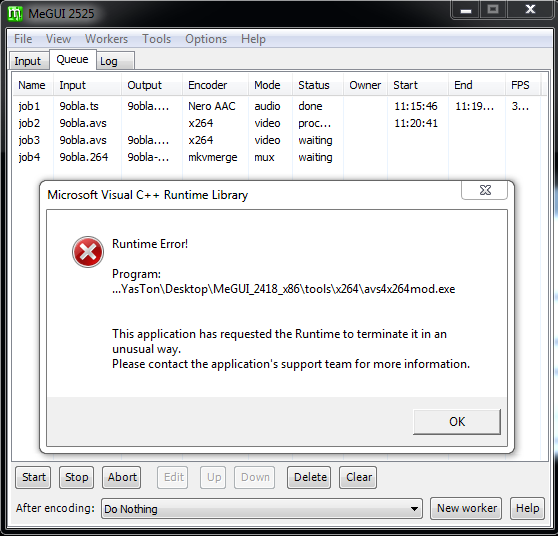

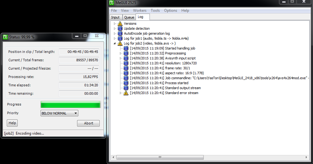

I've got a new error message in MeGUI, when my encode almost finish in the first pass, it shows this error:

Does it happen with ALL your video sources? If not this video source might be corrupt or something.
Does it create the video? -
So you recorded a game ... then it is indeed possible that the recording software did not handle the abortion of the recording well and left a slightly incomplete video file.
A pity you did not post all interesting details about this file (a MediaInfo analysis should usually be the minimum satisfying amount of information...). Therefore I cannot give you a certain recommendation; but you could try to use the Trim() function in AviSynth to cut off a few of the last frames, just to avoid the decoder failing there. -

Ah, you captured DVB(-S2?) HD directly into MKV? And this MediaInfo analysis is of the capture? This is quite strange. DVB captures are usually recorded as M2TS. And they are usually cleaned before processed further, e.g. to cut off leading and trailing incomplete GOPs. — Oh, you wrote that your software created 4 TS files, okay. Missed that earlier. I believe Cypheros TS-Doctor would have cleaned DBV HD recordings; ProjectX does not process AVC video.
Trim() is an AviSynth kernel function, no plugin required. Read about its syntax in the AviSynth Wiki: Trim
We are also missing your AviSynth script, especially which Source plugin you used. I hope you did not use DirectShowSource, but instead the File Indexer with L-SMASH Source (LwLibavVideoSource).Code:Trim(0, FrameCount()-2) # or a different number of frames from the end
