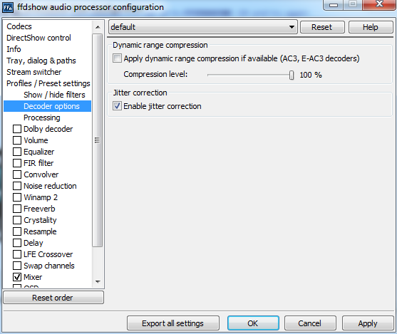

  9. Originally Posted by Cauptain View Post
    Open Codec Tweak Tool, Directshow Filters, ffdshow audio decoder and set ALL TO LIBAVCODEC. Make this in both x86 and x64.
    If not work go to PREFERRED DECODERS and set all to FFDSHOW. OK and try again.
    Reply.
    Claudio

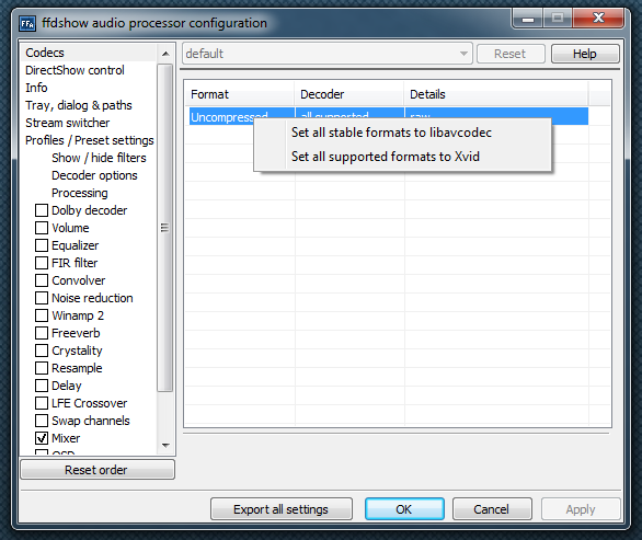

    I dont see anywhere to change it on the list. see uploaded photo of my options

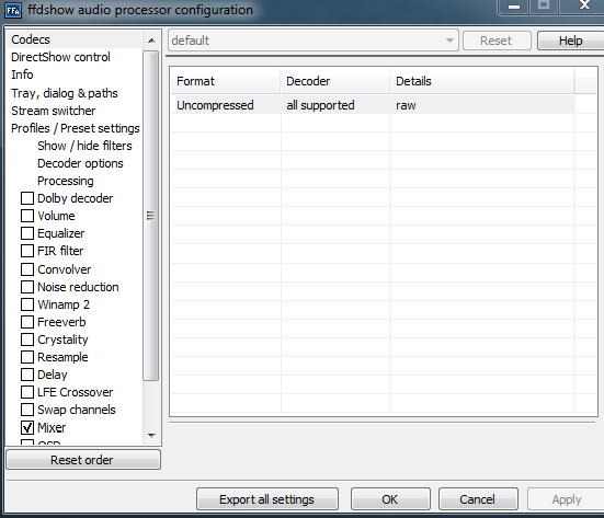

  11. Does nothing. I right click and set all to what you said and nothing happens. Apply is greyed out

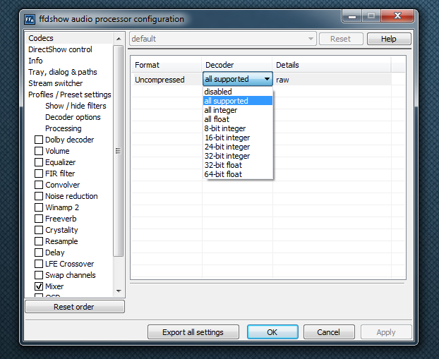

  12. and more

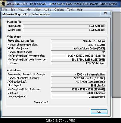

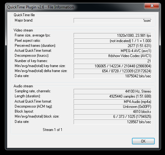

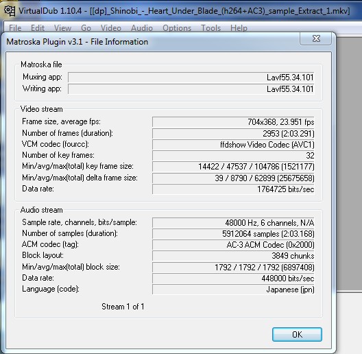

  13. Originally Posted by Calidore View Post
    With the file loaded, go to File | File Information. Under Audio Stream, what exactly does the codec line say?
    this
  14. Originally Posted by hopsmart View Post
    and more
    I may have to re-think my view on K-Lite and the world in general.........

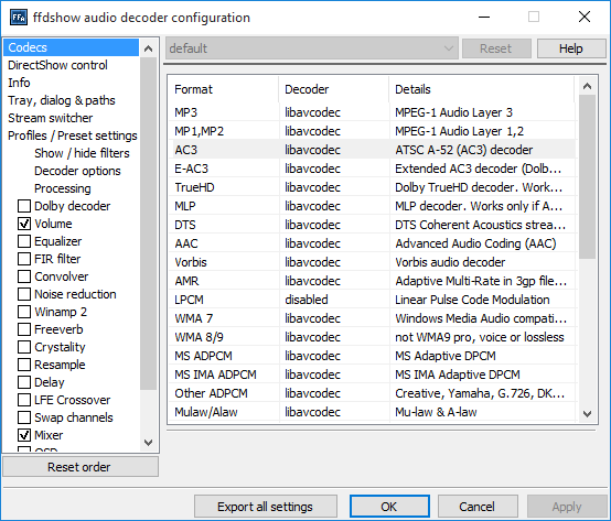

    It appears K-Lite has stripped ffdshow of all it's decoders. I assume the logic is it installs LAV filters as the directshow decoder because it's being actively developed. But..... Lav filters doesn't have a range of filters for processing as ffdshow does, so the K-Lite solution is for LAV to decode and output uncompressed audio and video and for ffdshow to process that audio/video. That way, you can still take advantage of ffdshow's filters without doubling up on decoders for every format.
    That's an educated guess as to why the only ffdshow codec option is "uncompressed" in your case. I use LAV in combination with ffdshow the same way myself, only I use a regular version of ffdshow without all the decoders removed. The second pic in post #12 indicates the "set all all stable formats to libavcodec" option might re-enable many of ffdshow's usual decoders. Maybe at the same time it disables the those formats in Lav filters? Just an educated guess. I don't know.....

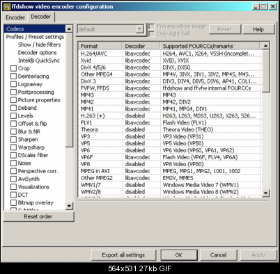

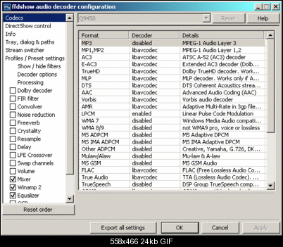

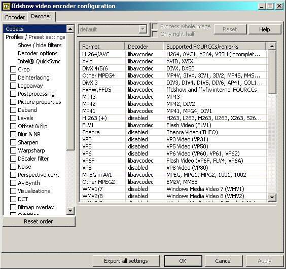

    The ffdshow VFW configuration would normally look like this under the codecs list:

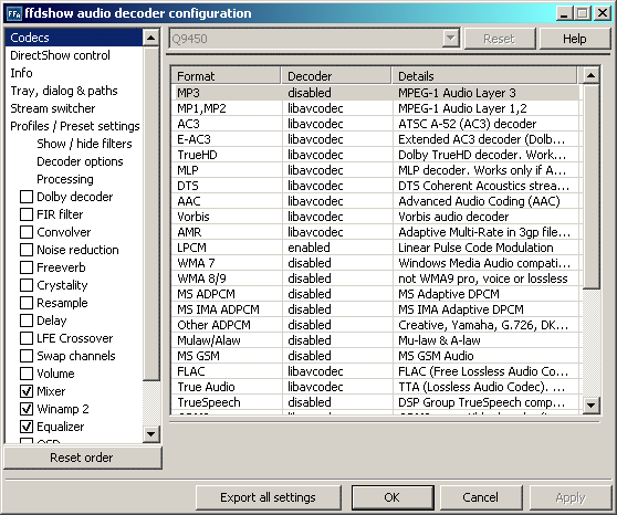

    And the audio configuration like this:
    Unless I'm wrong about how VirtualDub works, it requires Video for Windows codecs to decode the video and ACM codecs for the audio, so I'm not sure how ffdshow can help there even if it didn't have all it's decoders removed. As Budman1 suggested, you need something like the AAC ACM codec installed. Or a plugin such as the ffmpeg input driver for VirtualDub. It'll let VirtualDub open all sorts of file types containing lots of different types of audio and video. The main downside is you can't use DirectStreamCopy for the video or audio when they're opened with the ffmpeg input driver as it decodes them. If you're re-encoding anyway, that doesn't matter.
    Because it is FFDSHOW AUDIO PROCESSOR no FFDSHOW AUDIO DECODER. Look:

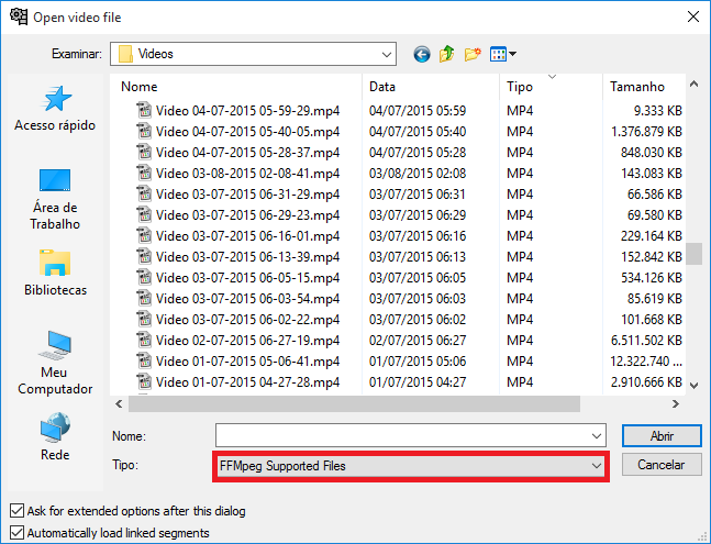

    Other tip, dont use Quicktime Plugin for open this file, use FFInputDriver.vdplugin
    Make this easy, link: https://www.videohelp.com/software/Virtualdub-AIO
    The installer contain all need.
    Any doubt, reply.

  16. Originally Posted by hopsmart View Post
    this
    I guess we were probably working under the assumption you were opening an AVI, but your screenshot indicates it's probably an MP4 or something similar. Not that it matters. I tried the Quicktime plugin and it doesn't seem to do much in the way of audio decoding, so the AAC ACM codec or the ffmpeg input driver would probably be a better option. Although you could open the MP4 with the Quicktime plugin, which should let you use Direct Stream Copy for the video if you wanted to, and under the audio menu select "audio from other file". In the window for selecting the audio, change the dropdown file type list to "ffmpeg supported files" and then open the same MP4 again (the audio doesn't actually need to be from another file). The ffmpeg input driver will decode the audio.
