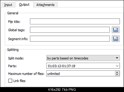

    So i have a 2 part movie (2 different .avi files - cd 1,2 ) and i want to make 1 file with a few cuts from those 2. Problem is - a scene is continued in the next movie part ......
    I'm using MKVToolNix v.8.3.0 ('Over The Horizon') 64bit, i add the first part of the movie (cd 1), then add cd 2 as an additional part to the existing input file - cd 1. I then proceed to Output - Splitting - by parts based of time codes. The length of cd 1 is 01:12:35.
    The scene i need help with starts at 01:03:12 and is continued in the next movie part, ending at 00:24:44 in cd 2. One solution would be to just join the 2 cd's and then do the split, but i was wondering how to do it the other way. The scene ends in cd 1 at 01:12:35, so i added another 24:44 to that time - giving me 01:37:19. I try to split like below, but the resulting file is only from cd 1......
    Any ideas, please ?
