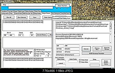

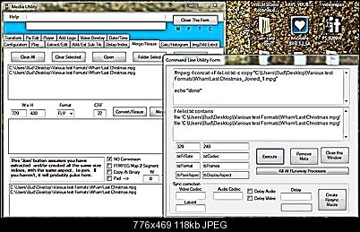

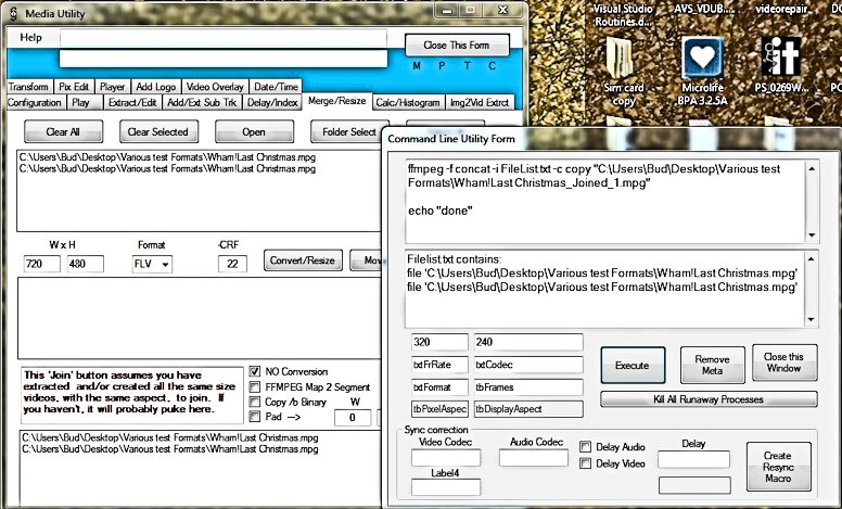

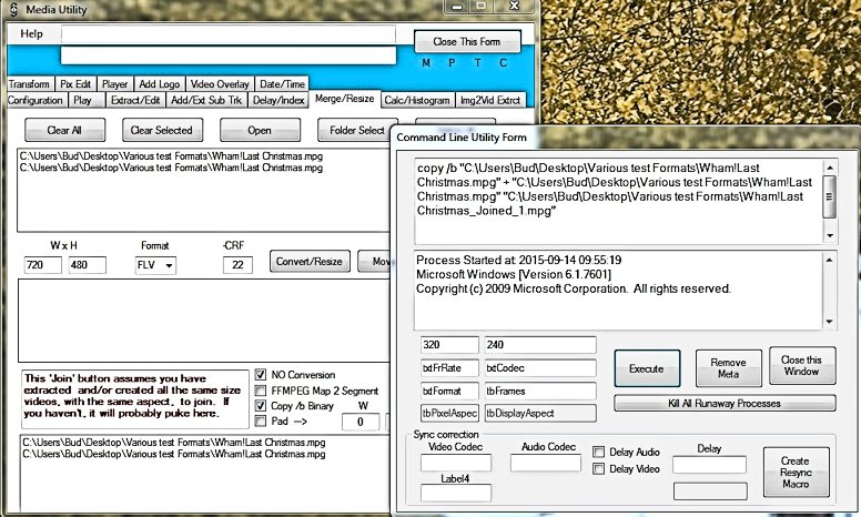

    Basically there are 2 methods I use to join files, Binary joining and ffmpeg concat. Different formats work with Concat and others work with binary.Checking several formats gave me these results:
    FLV ffmpeg concat=joins OK plays both, length is both
    FLV copy /b = 2 complete movies but time says only one and plays one
    MKV ffmpeg concat=joins but first subtitle
    MKV copy /b = 2 complete movies but time says only one and plays one
    MP4 ffmpeg concat = joins but loses DVBsubs and srt subs
    MP4 copy /b= 2 complete movies but time says only one and plays one
    VOB ffmpeg concat = multiple errors trying to join and aborts
    VOB /b works and carries over the DVD subtitles
    3GP ffmpeg concat=joins/ plays fine Subtitles ??????
    3GP copy /b = 2 complete movies but time says only one and plays one
    FLAC ffmpeg concat= Multiple errors during conversion. Fails
    FLAC copy /b = 2 complete movies but time says only one and plays one
    MPG ffmpeg concat=joins/ plays fine. Gives correct time and size. Subtitles ??????
    MPG copy /b = Seems to play ok but Time and size is given as only one video.
    M2V = Same as MPG
    M2V /b copy = Same as MPG
    The formats for each are:
Name:	ScreenHunter_164 Sep. 14 09.56.jpg
Name:	ScreenHunter_164 Sep. 14 09.59.jpg
