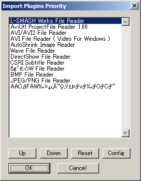

  7. When you did your tests, did you make sure l-smash was at the top (close then restart) ? You checked for 1.11, but it's not clear if you did for 1-6

    I just tested with 1.6: It fails importing the MPEG file and the VOB-massaged MP4. And 1.11 is supposed to be crap too (cf. beginning of this thread). So which version should I use?
    Yes, in 1.10, L-Smash is as the top:

  9. The problem is it detects your clip as 60000-1001 (59.94 fps) . So not only is it getting the field vs. frame mixed up, it's getting the "PAL/NTSC" framerate mixed up. There's going to be lots of problems
    I would use "'AviUtl_ExtraPack1-6[XP]Release" if you can, it also preserves 5.1 audio when you setup the l-smash configuration
    Did you close and re-open to check L-smash is up top? Also delete the .lwi index before you try re-importing the file .
