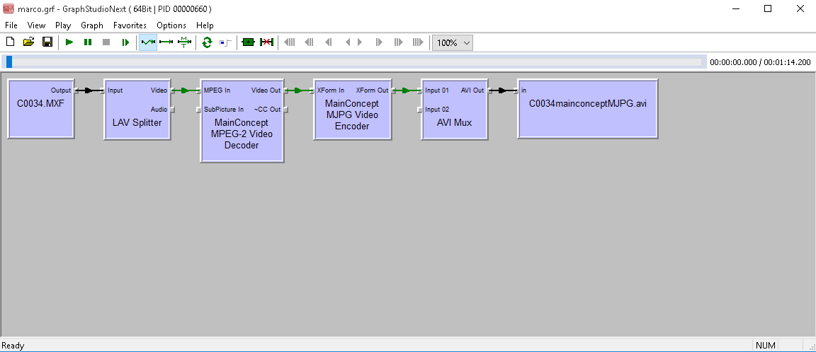

  10. You can encode it with graphstudio x64 because they are directshow x64 codecs. No it's not a very user friendly way to do it. Vdub cannot access directshow for encoding, at least not directly, therefore you cannot use vdub x64.

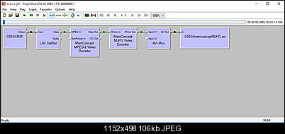

  13. I have tryed to "encode" my mxf catfile into .avi mjpeg with 64bit windows.
    The encodyng process employs 1 minute and 14 seconds but at the end of encoding it need other 1-2 minutes maybe to write the file. So that encoding is too long. Is there a way to "encode" saving the maximum time?
