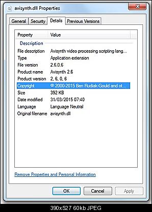

    Look in C:\Windows\SysWow64. Do you see avisynth.dll there? Right click on it, select Properties, go to the Details tab. Does the information look right?
    Everything looks fine - see photo.
    I'm lost - have to say?

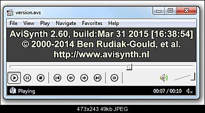

    Ok, here's one for the books - which (a) I never had to do before when installing Avisynth and (b) never expected it may be required?
    I just uninstalled Avisynth again (2nd time), ran C-Cleaner again, cleared new reg again & rebooted (even though it wasn't required).
    Here's the thing I never had to do before, because it never caused a problem. I gave this a shot out of desperation because I had tried everything else I know.
    I temporarily disabled AVG, then ran Avisynth installer again (as Admin again) and then - re-activated AVG. Ran the very same script as before and 'bingo', everything suddenly worked?
    What the hell is that all about? (I've always had AVG running every time I've installed Avisynth, updated it, or even tried installing the 64-bit Avisynth (successfully) a few weeks ago. The two never conflicted before?)
    Anyway - it's working now, but seems very strange that AVG somehow prevented it or conflicted with it - without even giving me a splash-screen or warning that something was detected or wrong? The Avisynth installer 2.6 was downloaded from the Videohelp website, so hardly a bad copy and it's working now anyway, so was obviously ok?
    Very odd.
