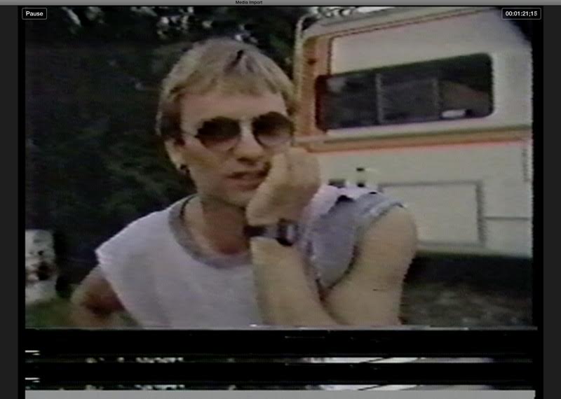

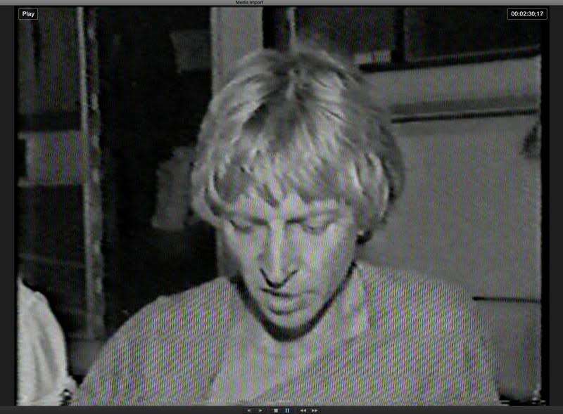

    Hi everyone,
    I am revisiting some VHS tapes that were converted for me a few years ago.
    I have some video conversion gear that I doing my own transfers with and am rearchiving in order to compile some new DVDs with footage in chronological order.
    I am hoping someone might advise me about a PAL / NTSC issue I appear to be encountering. I have learned a couple more things since I first posted about this issue, hence I am posting this new thread. ie I checked some old tapes that I am familiar with and I came across the issue again, showing the tapes are not the problem – it is evidently my chain.
    The attached images illustrate the problem under the circumstances I will describe. The problem is evidently in my conversion process or chain because a) VHS player > TV shows no problem ie I see a full 4:3 colour image and b) The finished product of a professional transfer some years back is also a full colour, full frame 4:3 image. That clarifies that the tapes are not the problem.
    As the famous Jagabo mentioned recently in a previous thread, It looks like what can in theory (to me) what might happen when NTSC tapes are captured in PAL mode, with the system expecting 576 lines but only getting 480. Again, the problem does not occur when I run straight to the TV and I have had some of the tapes converted by a professional service some years back with no such problem.
    My chain:
    Sony SLV E1000 > Panasonic ES10 (in pass through mode, as this has excellent image stabilisation and will even the most cruddy tapes produce a clear image) > Canopus ADVC 100 > iMac (FCPX).
    Here’s what I’ve tried:
    ES10 in PAL > ADVC in PAL mode
    ES10 in NTSC > ADVC in PAL mode
    ES10 in PAL > ADVC in NTSC mode
    ES10 in NTSC > ADVC in NTSC mode

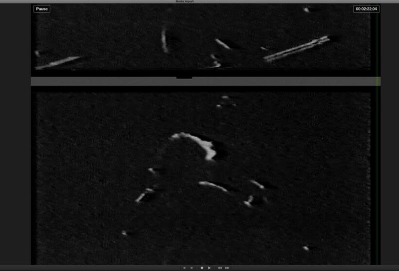

    Bypassing the ES10 altogether produces a constantly rolling BW image with the ADVC in NTSC mode and no image at all in PAL mode.
    The VCR PAL / NTSC settings have also been tried in all permutations and the image either does not change either way, or when it is switched to NTSC the tape is actually played slower and the image still BW.
    Essentially what it all comes down to is that when the ADVC is in PAL mode, I get a full colour, clear image which is “squashed” to something like a 14:9 ratio with black spacing below. When the ADVC is in NTSC mode, I get a full frame 4:3 image but the image is black and white. The colour system PAL / NTSC toggle on the VCR makes zero difference to this.
    I get exactly the same results with my alternative JVC player. Note again that running straight from VCR to TV is fine and when I had someone convert these tapes, the output image was also fine. It’s something in my chain or that I am missing or doing wrong...
    Any advice would be really appreciated! I need to get these conversions done myself at home and I want to establish how to do so properly for NTSC videos. I have no such problem with PAL videos. I am hoping that the only solution is not to buy an expensive new thing as the Aus to US exchange rate is terrible now and I am not exactly cashed up....
    Thanks!

  2. Can you upload short sample videos? Try to include shots with a moderate amount of motion so we can see if there are missing or duplicate fields/frames.
    Though I think this may be a PAL60 problem. When PAL VHS decks play NTSC tapes they output a hybrid signal that has NTSC timing (59.94 fields per second) but with chroma on a PAL subcarrier. PAL TVs are designed to display that properly. But most capture devices will not capture it correctly. If you set the capture device to NTSC you will get an NTSC picture with no color.
    If this is the case there are two ways around it. Get a capture card that supports PAL60, or get a pure NTSC VHS deck and capture as NTSC.

    Yeah, PAL60 signal captured as PAL.
    Two solutions:
    1) A capture device capable of PAL60 (you would also have to exclude the ES10 for passthrough as it is not PAL60 compatible!). Older PCI TV capture cards are very often capable of PAL60, but are inferior in many other ways...
    2) A VCR that outputs NTSC tapes in NTSC.
