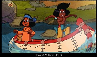

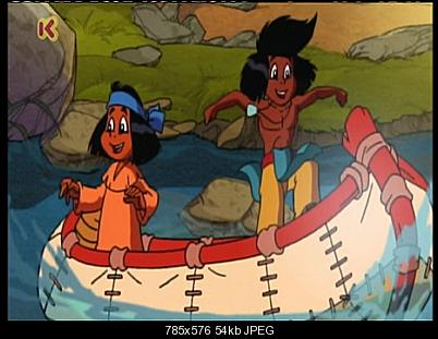

    I am currently trying to change the AR in dvddata files from TAW, without re-encoding. I use Womble to do this but the newly made file is 1s shorter than the original. Is this alright or should I stick with TAW ? It only took 10 min to output a whole DVD with changed PARClick image for larger version

    Here is a snapshot from the same frame but in different PAR. Which of them seems most natural ? I am getting confused.
    When should I change to DAR and when in PAR ?

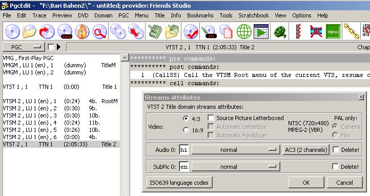

  2. Assuming these are complete DVDs (IFOs, BUPs, VOBs) and you plan on playing the DVD and not the VOBs, it's easier and faster using PGCEdit. Open the DVD and right-click on the video in question and 'Domain Stream Attributes'. In the new 'Streams attributes' screen change it from 4:3 to 16:9 and Automatic Letterbox. 'OK' your way out of there, save your changes, test and burn to disc

  3. Thanks for the quick reply. No, they are not complete DVDS, they are ripped with TAW to cut away the commercials etc.
    So in other words, no VOBs, IFOs etc.
    I know about PGCedit but I cannot use it on ripped files right ?
  4. That's right, PGCEdit requires DVD sources. But you're not clear at all when you say:
    In what format are they? MPG, or something else? If MPG you might use DVDPatcher. If something else you'd have to be more specific, but your current method is probably the best since you get a real DVD back with the corrected DAR at the same time..

    which snapshot does look more natural to you ?
    The second or lower one. Better, though, might be to find a scene with something round - a sun, moon, ball, etc.
