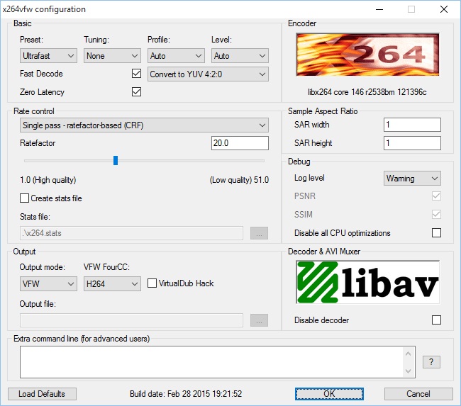

    I need help with a video that I made. Heres the situation. I use dxtory with the x264 codec with those settings below:

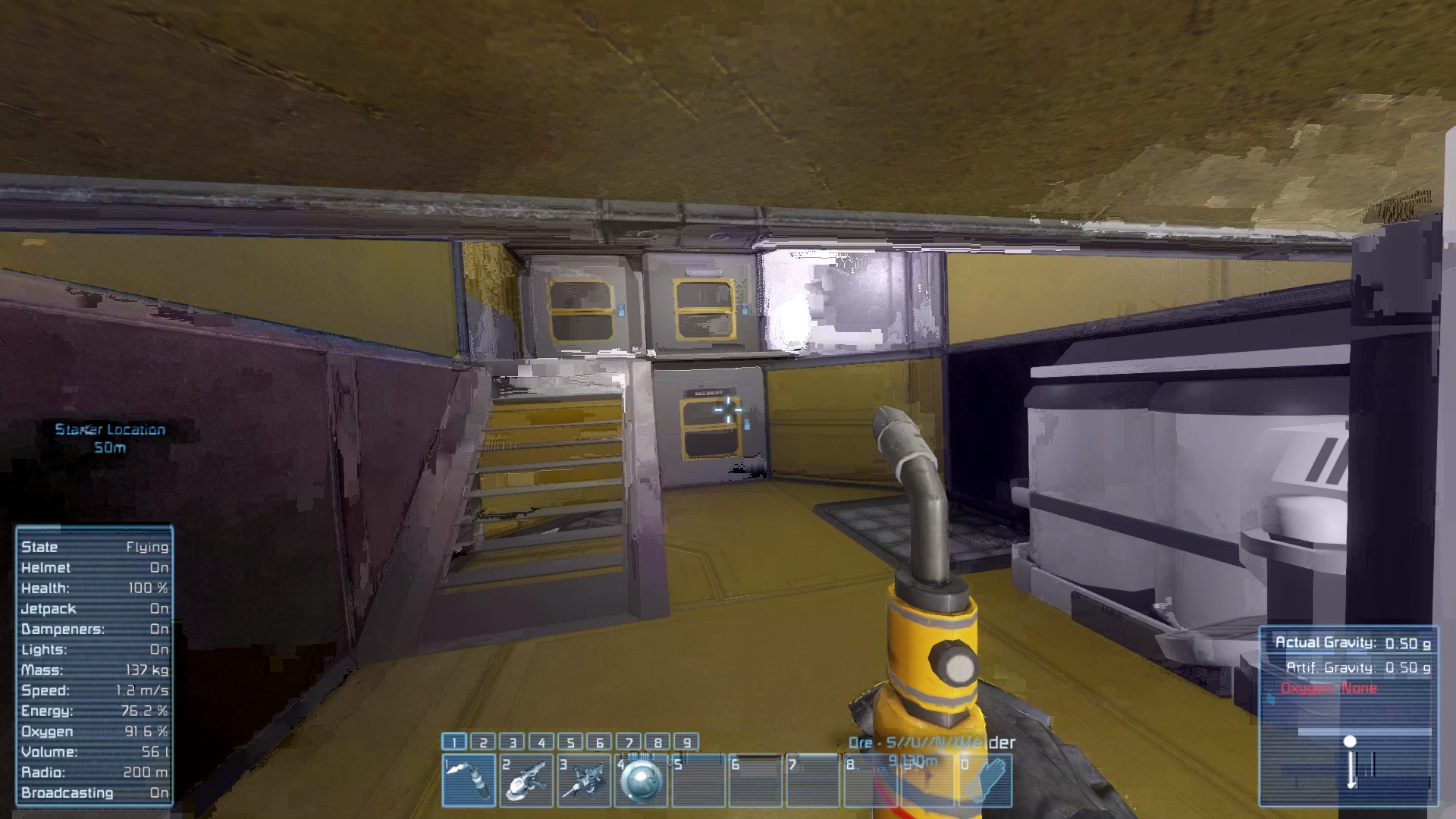

    So I fire up Sony Vegas and this is where the problem starts. I have a hunch what the problem is but I don't know what to do.
    Heres a picture of the video when I view it in Sony Vegas. The quality is really ugly and its like that all the time. I have a guess its because the video is already compressed and coded so when I go in Sony Vegas, it compressed or encode it more so it losses data or something

    Is there a way to render the video in Sony Vegas without looking that ugly ? Btw if I view the file before I go in Sony, it looks wonderful but when inside sony and rendered, its very ugly like this above

  3. @DB83 - I think he's saying the preview is already messed up, before exporting
    That suggests it's a decoding issue, especially since other programs don't have the problem (means video is actually OK, not corrupted)

    thats exactly whats going on. the video is fine if I look at it using vlc for example. But inside vegas, its already messed up. So when I render it still looks messed up. I'm pretty sure its my setting in vegas. I'm sure I can use some kind of setting to "fix" it.

  9. If decoding is a problem in vegas, forget about encoding. The errors will just propagate into the encoded export. You have to fix that first before anything else
    Vegas uses different decoding pathways based on the input file container. h264 in AVI is decoded by the system installed VFW installed decoders. It's the least stable and most prone to errors in vegas, especially when b-frames are used. In the screenshot , "ultrafast" is used, which disables b-frames. However, it's still using default --keyint of 250. This large GOP size can cause decoding problems in vegas, hence the recommendation to use I-frame only. (I frame only means each frame is encoded completely, without relying on adjacent frames - there is no temporal compression. This is similar to what lagarith and utvideo use - that's one big reason they are more stable). To do that in x264vfw, it was already mentioned enter --keyint 1 in the box
    If you re-wrap the AVI into MP4, then vegas will use either the mainconcept decoder or quicktime decoder. Both are better , less prone to errors than the h264 in AVI decoding pathway for vegas. If the major brand is "mp42", usually mainconcept will be used. That's the preferred one, but both are better than AVI . This is why re-wrapping was suggested as a "quick fix" workaround to salvage what you have. Re-wrapping is like taking the video out of one "box" and putting it into another "box" . It's very fast compared to re-encoding , and no quality loss.

    You can increase the quality by using a lower CRF value (in the first screenshot you have it set to "20", lower values will increase the filesize and quality). The compression is much lower with smaller keyframe intervals. With I-frame only , on average you'd need about >50% more bitrate for roughly similar quality as your "normal" settings. (That's a very generic statement, that value will vary on the type content)
