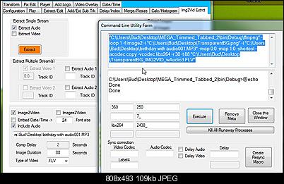

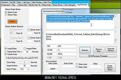

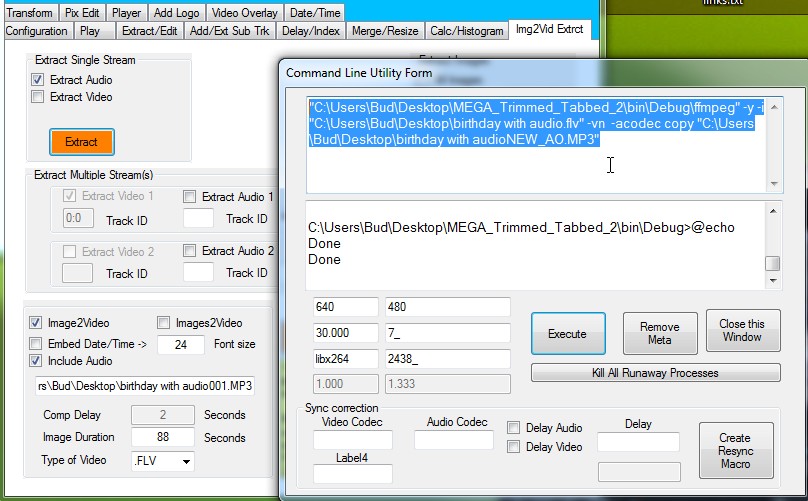

    Adding to the excellent suggestion from Jagabo... The following are the sequences for extracting audio with copy:
Name:	ScreenHunter_162 Sep. 06 23.05.jpg

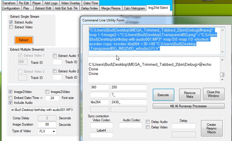

    And the sequence for creating a video with an image (notice 88 Seconds for Audio time):
Name:	ScreenHunter_163 Sep. 06 23.23.jpg
    Batch will take a little longer to set up because the filename, extensions (unknown codec before extracted from video) have to be obtained before the FFMpeg script can be written correctly. In my case it is an MP3 and it automatically fills it in except this portion is not batch in my program.
    Last edited by Budman1; 7th Sep 2015 at 00:27. Reason: Stupid images went in reversed
