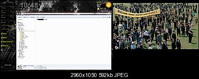

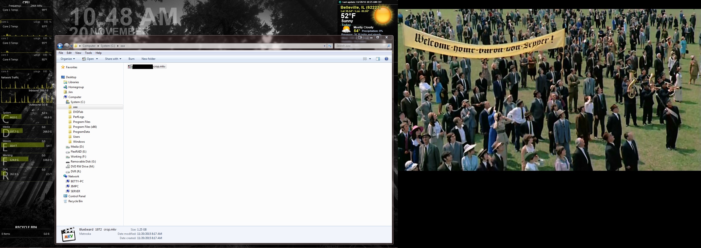

    I've got a few screen caps to show what I was trying to explain.
    Here is a capture of my desktop. The left is the main monitor (22" 1680x1050) and the right is a TV (720P). It's hard to see specifics, but you can see the black border at the top of the image and there is a matching border on the bottom. The side borders don't show much in this image.

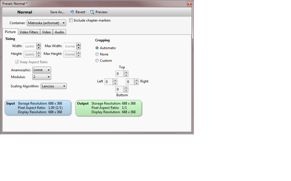

    Here are the video specs as detected by VidCoder, and you can see that it doesn't show any borders to be removed. Typically, when a file isn't displaying properly, when opened in VidCoder, it will auto populate which side(s) of the image to be cropped.

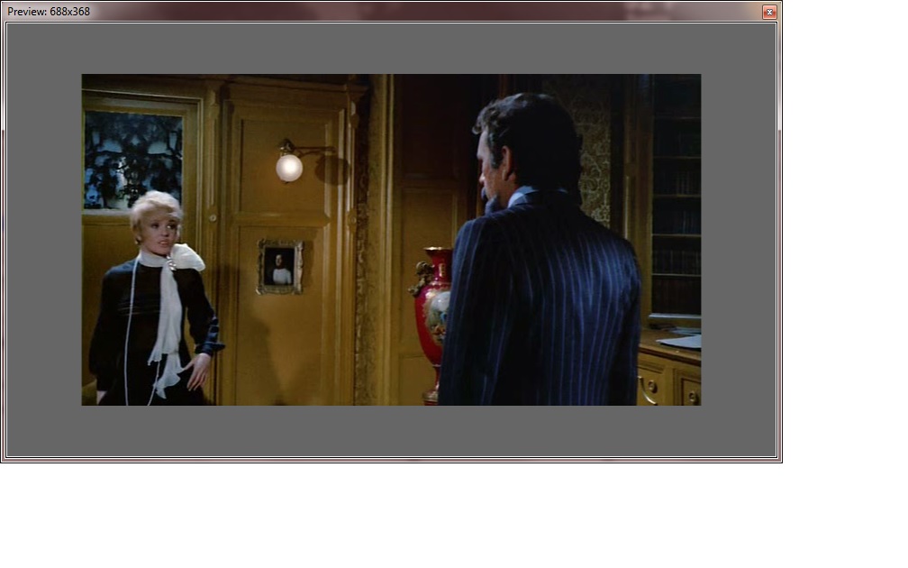

    Here is the preview image supplied by VidCoder from the editing screen above. When no borders are present, the image will fill the preview panel. In this image, you can see that VidCoder is recognizing a border around the entire image. Which is exactly what I see when watching the file.

    The only thing that comes to mind, and I'm stretching here as I don't completely understand yet how all of this works, is that the border is simply a byproduct of the current resolution.

  7. Originally Posted by Krispy Kritter View Post
    The video is roughly 1.85:1 (a common movie aspect ratio) so it should not fill a 1.78:1 (16:9) screen. There should be small borders top and bottom. It looks to me like everything is working like it should.

  9. I don't see any borders on the left and right edges of your TV image. Keep in mind that some videos include ~8 pixel borders at the left and right edges because they were made analog tapes with standard rec.601 capture devices. You can crop those borders if you want. But a 1.85:1 video will not fill a 1.78:1 screen unless you distort the picture (stretch it vertically) or crop a bit of the picture off the left/right edges.

    Well I found part of the problem. After a recent power outage, my display settings had changed somehow. So that accounted for most of the border I was seeing. Still not exactly right, but I can live with it as everything else I've tested is still normal.
