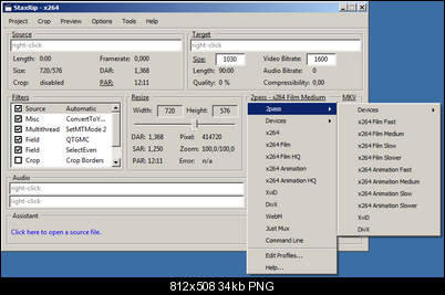

    How do I set up a filter or integrate QTGMC as the de-interlacer in Staxrip (preferably on the older x86 version, or via VapourSynth in the newer x64 version?)
    I know it can be done, because I've seen other guys on various forums with it integrated - as per photo attached.
    I'd appreciate if someone could post instruction to help out? (I have Googled for hours trying to find out how, but I haven't found anything that was a comprehensive step-by-step guide to doing it. i.e. for someone who is not an IT Professional or writes coding.Click image for larger version

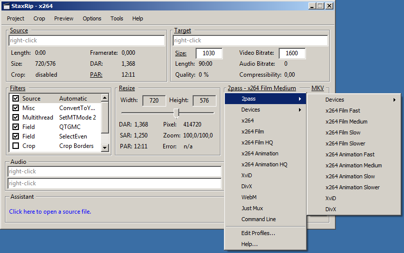

  3. Ahhhhh... not too hard when you know how.
    This is using the 32 bit version but I assume the 64 bit version works in a similar way?
    Right click on the filters list and select profiles.
    In the window that opens, I added this to the end of the "Field" section.
    Advanced | QTGMC = QTGMC()
    Now QTGMC appears under "Advanced" after right clicking on the"Field" filter.
    To load the required plugins, assuming they're not in the Avisynth auto-loading plugins folder, would something like this be the easiest way to do it?
    Advanced | QTGMC = LoadPlugin("E:\Plugins\plugin1.dll")%newline%LoadP lugin("E:\Plugins\plugin2.dll")%newline%QTGMC()

    thanks, there was one change made to make it easier to add multi-line profiles, the %newline% macro was removed in favor of a multi-line syntax, it looks now like so:
    Advanced | QTGMC =
        LoadPlugin("E:\Plugins\plugin2.dll")
        QTGMC()
    Quick access to the auto load directory is at main menu > Tools > Directory > Plugins, this works now also for VapourSynth.
