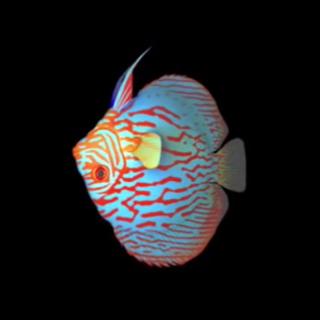

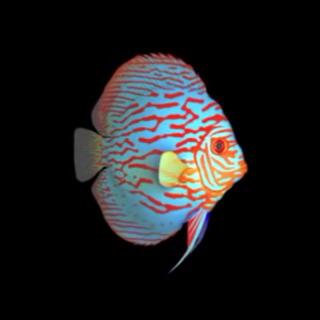

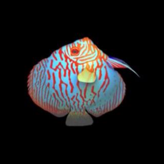

  2. Create four 90 degree rotated version of the video. Join them together in a 2x2 matrix. Rotate 45 degrees.
    Original video and rotations:

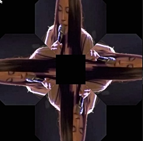

    jagabo, First I turned the single image into a video and used it as an inout to your script but I kept getting an error on the script you posted but I rearranged it and since my photo wasn't square(error on height mismatch during stack) I used:
    v1 = DirectShowSource("C:\Users\Bud\Desktop\image001.fl v").converttoyv12.lanczosresize(320,320).rotate (-45)
    v2 = v1.TurnRight()
    v3 = v2.TurnRight()
    v4 = v3.TurnRight()
    StackVertical(StackHorizontal(v1,v2), StackHorizontal(v4,v3))
    Rotate(45)
    Playing this AVS file resulted in:
    Name:  Correct Rotation.jpg
    Using non Black background shows the more creative result orientation:

  6. Yes, the image has to be square to use the stacking sequence in that script. In another video I used the same -45 degree pre-rotation to level the images.
