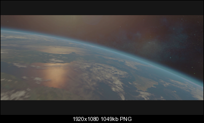

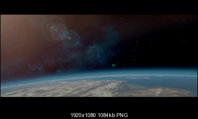

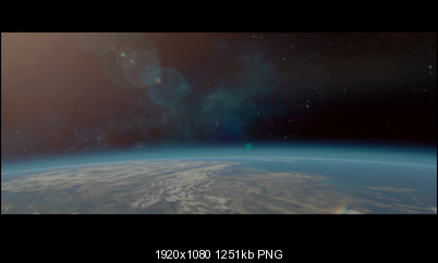

    Hi,
    I've been playing around with BD Rebuilder for some time now, testing most encode options to see which works best, and I've noticed that no matter what encode option I choose the blacks becomes a lot brighter than what they are in the original source. I'm using the BD-25 target option and I've tried most /Encode/ options there are, including CRF and ABR variants of them, but the result is always the same, washed out blacks.
    I've attached two screenshots, one from the original .m2ts file and one from the encoded .m2ts file, and as you can see the blacks are brighter in the encode (most noticeable in the bars above/below the picture). This encode screenshot is from using the BD-25 target option and the High-Speed encode option (but it looks exactly the same using e.g. the High Quality option).
    Any idea why this happens and what, if anythinig, I can do to prevent this? Thanks for your help.

  2. How are you determining this ? What player / renderer ?
    Do you have more than 1 player open at a time ? The most common mistake is to have multiple instances when comparing, and they use different renderer and settings. Close player one and view one at a time .
    VLC, one instance. I open the original, take a snapshot, close it, open the encode, take a snapshot, and close it.
    This issue is not only visible when playing them in a SW player, it's also visible when playing the encode/comparing the two in my standalone Panasonic blu-ray player.
  4. pc.709 (full range YUV, 0-255) vs. rec.709 (limited range, 16-235) levels. Don't know why the program is doing this.
    Sep 2015
    EU
    I'm sorry, I don't understand this fully. Is this a known (random?) issue with BD Rebuilder (no one can get true blacks in encodes?), and/or is this something I can change in a setting/.ini manually to force 'pc.709'?

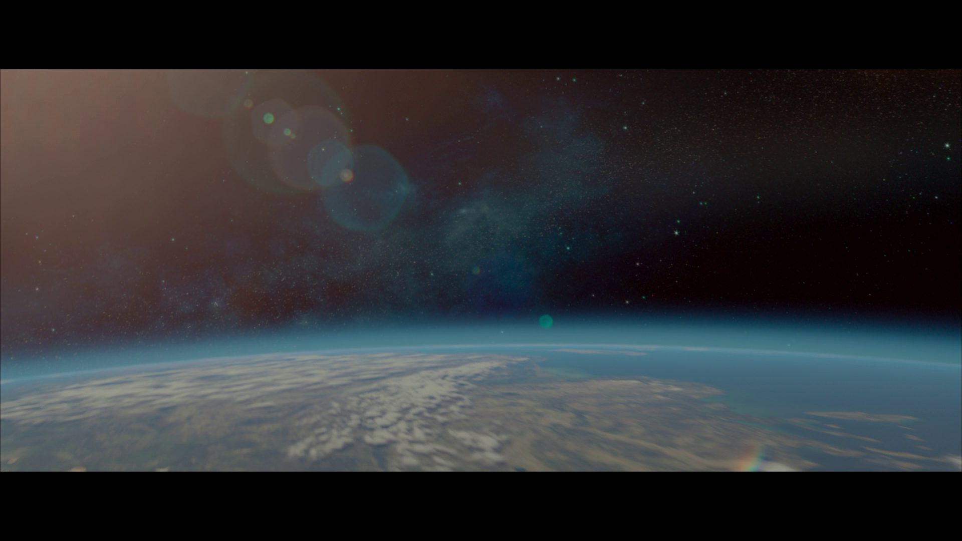

    Success! It was the CoreAVC settings that was causing the washed out blacks and resetting these solved it (see encode snapshot below)!
    Thanks for all the help/brainstorming, appreciate it a lot! And thanks poisondeathray for pointing me in the direction of misconfigured filters (and to jagabo for educating me on 16-235 vs 0-255)
