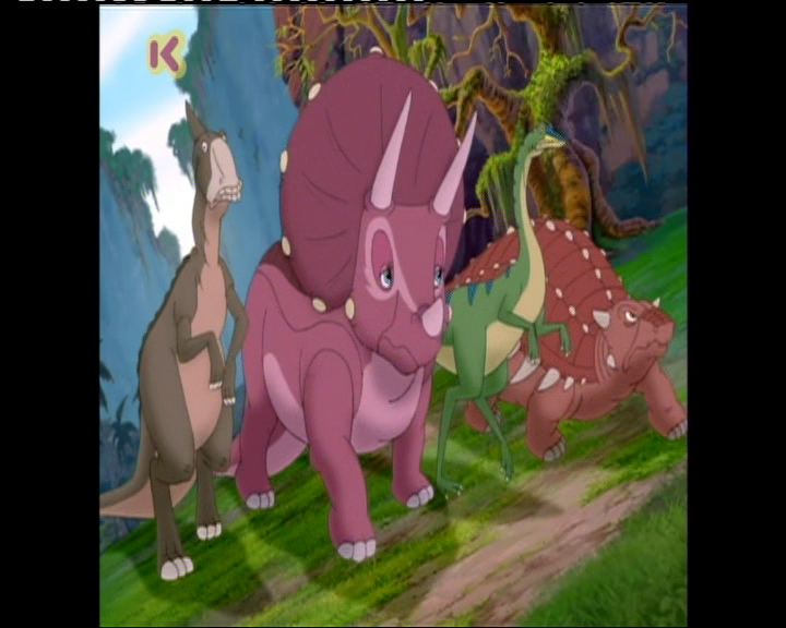

    After a long absence in making video recordings I am struggling a little to find the correct setting.
    I am usinga Sony RDR-HX680.
    This doesn't seem the case with programmes in 16:9
    Could anyone shed a light ?

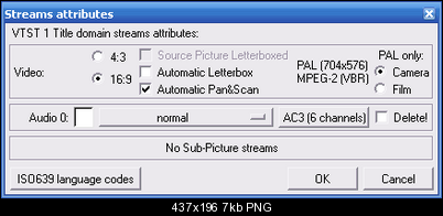

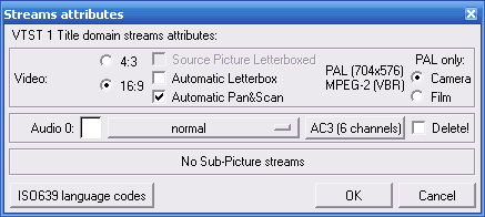

    7. At the top of the pgcEdit window, click the "Domain" menu and select "Domain Streams Attributes" from the drop-down.
    8. A sub-window will open showing the current setting of that video as "4:3" To change it to the correct widescreen flag, click the little white button next to "16:9." This will also activate "Automatic Letterbox" for when the DVD is played on an old 4:3 CRT television. Click the "OK" button to save the new flag and dismiss the window. Repeat steps 6, 7, and 8 for any other widescreen Titles you have on the DVD (if more than one).
    Be careful NOT to change the setting for any proper true 4:3 (or letterboxed 4:3) videos you might also have on the same dvd- otherwise these will be distorted. For example, if you have a dvd with six TV episodes from different eras, some widescreen and some "old-school," you only need to change the widescreen ones to 16:9 domain setting.

    It looks like the receiver you connect the Sony to is pillarboxing the video so that the output frame is always 16:9 rather than adaptively switched between 4:3 and 16:9 depending on the programme.

    Skiller: Yeah, I think that 's the case. I guess the video from which I took the snapshot is ruined right ?
    UPDATED: ALSO SEE MY FOLLOWUP POST #17 BELOW: Yes and no. In one way, the recording itself is fine: this is how dvd is designed to work, with widescreen material squeezed into a 4:3 frame that is later unsqueezed by the player and/or TV. The problem lies with your set top box incorrectly squeezing 4:3 as if it were also widescreen, instead of leaving it be. Your Sony 680 is incapable of over-riding this broadcast error: it doesn't implement framing flags, it records exactly what it is fed. You just need to rip the original recorder dvd VIDEO_TS folder to your PC, and add the auto-unsqueeze 16:9 flags per my instructions (or using other utilities as suggested in the other replies you've received). When you copy the modified VIDEO_TS folder to a new duplicate disc, that disc will function exactly as you would expect from a commercial Hollywood disc. When played in a hardware or software dvd player, all should be well with such modified 4:3 recordings, but converting from dvd to other video formats will be tricky because of the incorrect double-squeeze.

  21. Originally Posted by orsetto View Post
    Do you know if pgcEdit sets both the IFO and VOB flags? I vaguely remember asking the developer once, and I think he said it does, but I'm not positive. Have you ever used pgcEdit for this type of setting repair? So far I have not had any AR issues playing pgcEdit dvds on any hardware/software I've tried, so the compatibility point you mentioned may be rare, but I'd still like to be sure all my bases are covered.
    PgcEdit changes the AR flag in the IFOs only. You need to use DVDPatcher or similar to change the AR in the VOBs (and, ideally, you need to patch the entire file, not just the first occurrence).
    Anyway, the IFOs should always have precedence. It's clearly required by the DVD specs. If your player uses the AR from the VOBs instead of the IFOs, it has a bug. (Of course, that does not apply to the players that can play a VOB file directly, in file mode instead of "DVD mode".)
    I just noticed upon re-reading the older thread you linked, Skiller claimed pgcEdit does simultaneously patch two attributes when AR modifications are entered:
    You can also use PgcEdit to patch the IFOs – it changes the flag in both places (VIDEO_TS.IFO and VTS_xx_0.IFO) so it's less tedious than using IfoEdit.
    Sorry if I'm being dense, but is that what you are referring to when you recommend patching both IFO and VOB? If pgcEdit operates as Skiller suggests, does it cover both your concerns?
    The AR information of a Title is stored in several places: in the IFO of the titleset of the title, in VIDEO_TS.IFO, and in the VOBs. IfoEdit doesn't change the flag in the VOB of course, and furthermore it changes it only in the IFO you are explicitly editing. Therefore, you need to edit two IFO files to change the AR correctly (although most players look in the IFO of the titleset only). PgcEdit changes it in VIDEO_TS.ifo and in the IFO of the titleset at the same time.
    In addition to the domain attributes in VIDEO_TS.IFO and VTS_xx_0.IFO files there are also MPEG header aspect ratio flags throughout the entire MPEG stream, every single GOP has one.
    So to make it 100% compliant you need to
    – patch VIDEO_TS.IFO as well as VTS_xx_0.IFO (PgcEdit does both in one step)
    – patch the MPEG aspect ratio flag in every GOP (VOB files)
    That's perfectly correct, although if you play the DVD with a (good) DVD player, patching the VOBs should not be necessary.
