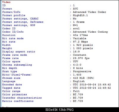

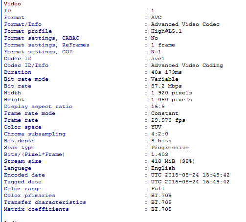

    the newer canon dslr 70D does all i-frame avc @ 90mbs with autofocus during video recording if you need that.

  15. Sorry, what is i-frame avc, never heard of it ?
    My goal is to have compression but I want the quality straight out of the camera, nothing like what MP4 does to a video etc.

    avc - advanced video codec or mp4. normal avc/mp4 has up to a 250 frame gop(group of pictures), that makes editing a nightmare. all i-frame or 1 frame gop is easy to edit as it can be cut at any point without any re-rendering. it's more like editing DVavi.
