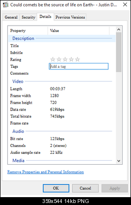

    why adding tags works with mp4 files but wouldn't work with mkv files ??
    is it possible at all ??
    Thanks.
