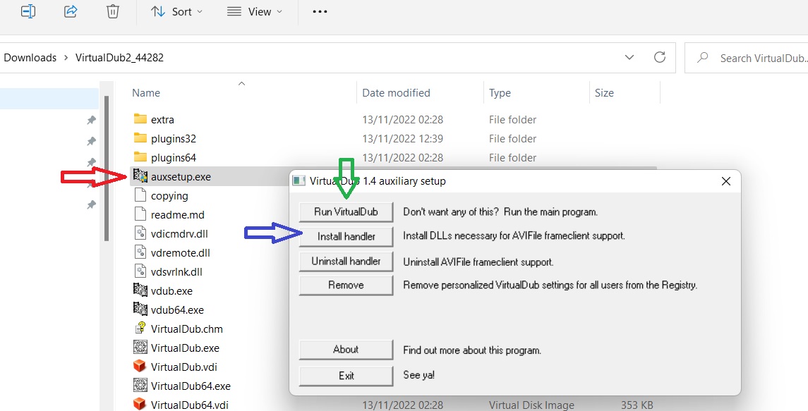

    Repeatable Solution , 32 bit mode, (Repeatedly checked on different Intel PCs): Copy the following 3 files from VirtualDub v1.7.8 to VirtualDub 2 (44282)
    auxsetup.exe
    vdremote.dll
    vdsvrlnk.dll
    run auxsetup.exe by opening / double clicking,
    Install handler, Run VirtualDub , Now plugin MSU Subtitle remover 3.0b2 wilil be working with VirtualDub 2 .
    Repeat above before every new project or modification.

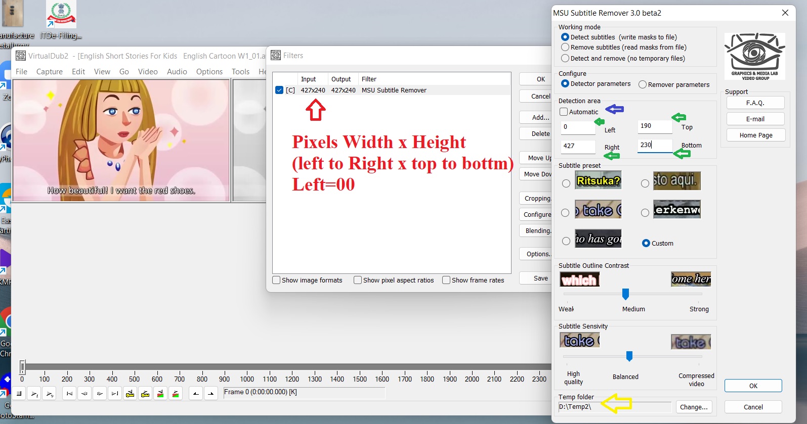

    NOTE:
    (i) Virtual dub filter should have write access to folder e.g TEMP , Now a days Windows restricts access to C Drive, hence write access to be granted or better to provide some folder on non OS, writable drive like D etc
    ii) MSU Subtitle remover 3.0b2 is not working with VirtualDub v1.10.4
    (iii) MSU Subtitle remover 3.0b2 is working with v1.7.8 but in my case Video is tilted few degrees towards left side (Checked many versions Virtualdub)
    (iv) If Detection Area is known e.g. if location of subtitles are fixed , it is better to select that area to avoid artefacts. The pixel size of video is shown by program , we have to assess the approximate pixel reference coordinates with + side 5-10 % extra area after unselecting Automatic
    Used as below
    1st pass - Detection
    Start VirtualDub and open your video
    Add MSU Subtitle Remover to filters (Video->Filters->Add)
    Select Temp folder preferably non OS drive
    by default Detect subtitles" in selected condition >OK
    click on special play button "Output playback" , wait until it detects
    For Second pass:
    Go to Video->Filters->select existing Subtitle remove filter > Configure > select Remove Subtitles (Read masks from file)>OK
    Save > as AVI
Name:	Handler installation.jpg
