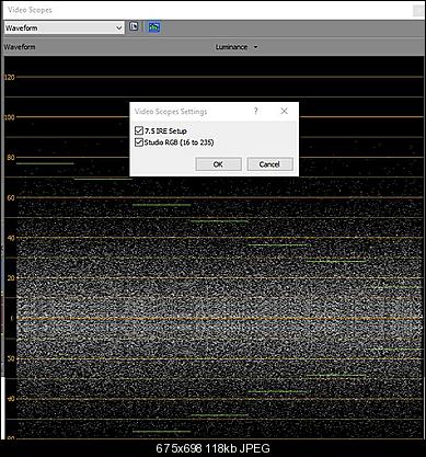

    Anyway, I might drop Premiere Pro. I am testing Sony Vegas right now, and it doesn't seem to have these issues. I was able to import lossless files effortlessly. Also, I checked the waveform monitor and it is not crushing the whites and the blacks.
  10. It looks to me like it is crushing the blacks. You've got a ton at -9 IRE. That's what the numbers represent, isn't it? When you see them piled up like that, it's not a good sign.

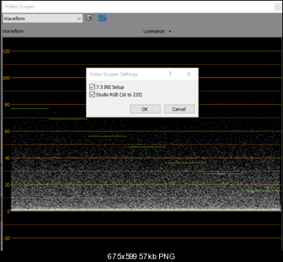

  14. Click image for larger version
    Some spikes are slightly over -20 IRE.

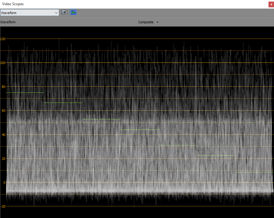

  18. How does that apply to the waveforms I just showed you? I don't see what the problem is. With Adope Premiere, everything was between 0 and 100.
  19. Originally Posted by Hypersonic1 View Post
    Which is where properly encoded video is supposed to be.

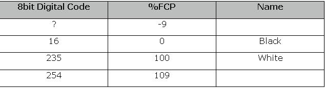

    Then why would it be crushed at -9 IRE?
    The link I gave earlier explained all that and more. The author wasn't entirely sure what -9% IRE mapped to but it's most likely 0.

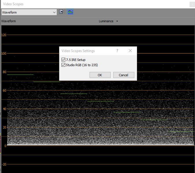

  26. Why doesn't this 7.5 IRE setup have any effect on the video? The waveform changes, but the video looks the same after checking the box.
  27. 7.5 IRE setup is in the analog signal. It's normally removed when the video is digitized. That's why the DVD recorder has the high/low option on the input.

  30. What makes you think inter station white noise would conform to international video standards?
    Whenever you see a solid white line at the bottom of a waveform monitor:

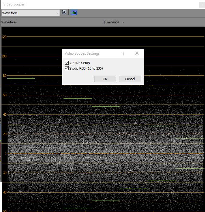

    the implication is that a bunch of data points below that line were pushed up, crushed, from below. Ie, the waveform originally looked something like:
