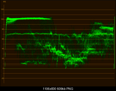

    Have you had a look at a histogram of both captures? There's a good chance the blacks aren't really gone, they may be just below digital black (16), somewhere between 0 and 16. Could be corrected post-capture easily.
  7. Click image for larger version
    The blacks never go below zero. That is the output of the ES-15.
    May 2014
    Memphis TN, US
    You better hope the blacks don't go below zero. Are you including any black borders in that histogram ? ? ? ? The ES-15 itself doesn't crush blacks unless you have the wrong IRE output settings in its setup. Or maybe you have a problem unit. I used the ES15, -10, and -20 for years, no problem with blacks. Looks like you have some clipped brights, but I don't know what your video looks like.

  9. You better hope the blacks don't go below zero. Are you including any black borders in that histogram ? ? ? ?
    Yes. Those two small vertical lines are where the black borders begin. They go below zero when I capture without the ES-15.
    I don't see where to change that in the ES-15's setup.

    First you complain about the behavior of the ES15, but you show us a histogram of an image that didn't go thru the ES15. The histogram shows a higher IRE (black levels, mostly dark grays) and blown-out brights. Kinda got us going in circles, dude. How about posting a short sample or some unprocessed images of similar frames, each from the ES15 work and the no-ES15 work.

  11. Actually, it might not be the ES-15. I am having the same problems with Premiere clipping the whites and blacks again. Also, I just realized that Premiere does not seem to support uncompressed files well. I tried importing an hour video, and it only recognized the first 2 or 3 minutes. I don't know what other format I can use other than DV that will not clip the white and black values, and will import the whole video in Premiere.

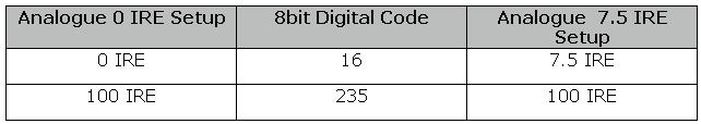

  15. I don't understand what this 0-16 and 235-255 is all about. I am talking about whites and blacks going below 0 and above 100 IRE.
  16. Originally Posted by Hypersonic1 View Post
    You should, since once your video is digitized IRE is no longer relevant. Below is a picture taken from an article discussing the subject:
    http://www.kenstone.net/fcp_homepage/video_levels_nattress.html
    Unless your black levels go too low (0) and the white levels go too high (255), then they can be fixed later on. And adjusting the brightness (black levels) and contrast (white levels) before capping can help as well. Just understand that the settings aren't mutually exclusive - one affects the other to a degree.
