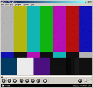

  12. Yeah, I saw your post asking about Staxrip and QTGMC. I have the 32 bit version of StaxRip installed. StaxRip won. I tried.... but couldn't work out how to add QTGMC. Hopefully someone else can help you. If not, I'll give it another shot later on.
    The normal process for adding QTGMC to a script (if you downloaded the 32 bit plugins for QTGMC you'll need the 32 bit Avisynth installed to use it, but you can install 32 bit Avisynth on a 64 bit PC)..... once you've put all the required files in the Avisynth plugins folder, including the QTGMC.avsi file... Here's an example of creating a simple script from scratch. Open Notepad and type the following:
    ColorBars()
    Save the file and change the extension to avs instead of txt. Call it anything you like. ie "FirstScript.avs". Open FirstScript.avs with MPC-HC. If Avisynth is installed and working, you should get this:
    Close MPC-HC and open the script in notepad again. Change it to this (I also added a conversion to YV12 because ColorBars is RGB and QTGMC might complain):
    ColorBars()
    ConvertToYV12()
    QTGMC()
    Save the script and open it in MPC-HC again. If Avisynth doesn't offer any errors (pretty much nobody installs QTGMC and all the required files correctly the first try, so don't get your hopes up) you'll be de-interlacing the color bars with QTGMC.

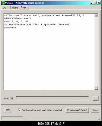

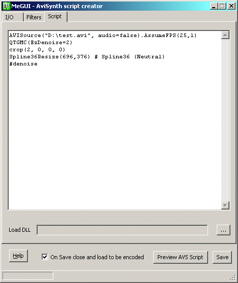

  13. Originally Posted by The.King View Post
    Hopefully there's a good guide out there for MeGUI along the lines of the three bears. (i.e. not too much [info], not too little either, but just right!) And with a bit of luck, it has QTGMC included in it's main download too? I'd welcome any further insight you might have.
    MeGUI doesn't include QTGMC, but it'll use it the same way if Avisynth is installed and all the required files for QTGMC are in the Avisynth plugins folder. In MeGUI's case, after opening a video with the script creator, you can switch to the script tab and add QTGMC() manually. Or you can create a script template with QTGMC included, so it's added to a script whenever you select that template.
    You can open a video by opening the AVS Script Creator under MeGUI's Tools menu and selecting a file as the Video Input. Start with an AVI if you can as it should open quickly without needing indexing. When you add it as the Video Input (under the I/O tab in the script creator), MeGUI should ask how you want to open it. Choose AVISource. The preview window should open automatically.
    MeGUI's script creator displaying the script.
    I removed the default de-interlacing line and typed in:
    QTGMC(EzDenoise=2)
    That's QTGMC with it's noise filtering enabled.

  26. Originally Posted by The.King View Post
    So if you could advise (after I install all QTGMC files from your earlier .zip file in the correct folders), how I go about adding QTGMC to MeGUI via a pre-loaded tab or option (if that is the correct term?) instead of having to manually add some command line instead. i.e. Either under the dropdown 'Avisynth profile' under the I/O tab after a source has been loaded & cropped, OR PREFERABLY (when a source is analysed as 'interlaced' under the 'Filters' tab, that I could hit the dropdown arrow and see an option for QTGMC, in addition to the already loaded Yadif, Yadif with Bob, TDeint, etc. - that would be great?
    Just switch to the script tab and type it in. There's even a picture showing how to do it in post #13. If you change something in the script creator GUI, MeGUi will re-write the script and you'll lose any manual changes though, so it's a good idea to copy it in case you need to paste it in again, or make adding QTGMC the last thing you do before saving the script.
    If you want to create an AVS profile, open the AVS profile config and replace this line:
    <deinterlace>
    with this one:
    QTGMC()
    Save that as a new preset. Call it whatever you like. Maybe "QTGMC De-interlacing"
    How it works. When <deinterlace> is included in an AVS template/profile, MeGUI can add de-interlacing to the script. When it's not, it can't. Same for <crop> or <denoise> etc.
    If you remove <deinterlace> you can still get MeGUI to analyse the video and the script creator will still tell you if it thinks the the video is interlaced, but no interlacing will be added to the script. Likewise, if you create a preset without the <denoise> line, no denoising will be added even if it's enabled in the script creator. That's how you'd create templates to switch between using MeGUI's filters and third party Avisynth filters.
    There's other options in AVS profile for allowing upsizing, setting the acceptable anamorphic aspect error, default mod, default resizer etc. All those options are saved as part of any AVS profile you create.
