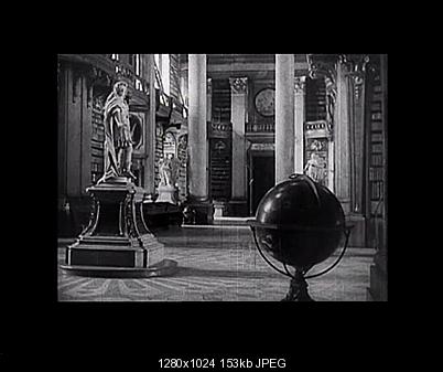

    Hello, I was wondering if anyone here has any advice. I have been going round in circles with the dvd. It looks great on 16x9 tvs but on 4x3 tvs it looks small and windowboxed. I want it to look ok for 16x9 tvs as well as 4x3. I have looked into various cropping and editing software but when I open it, it looks ok. The black at the top and the bottom is gone so there is nothing to crop. Am I going about this the wrong way?

  2. This may not be it, but it doesn't hurt to check. The DVD player connected to the 4:3 TV set, is it set up to output for 4:3 TVs?
    Aug 2015
    Seattle
    Well, I didn't even think about that. Actually, it was hooked up as 4:3 letterbox. If I changed it to 4:3 pan&scan it looks correct.
    I had hoped to have it play the same for anyone regardless of tv without having to know they should change the setting but it seems like it might be more trouble than it is worth.

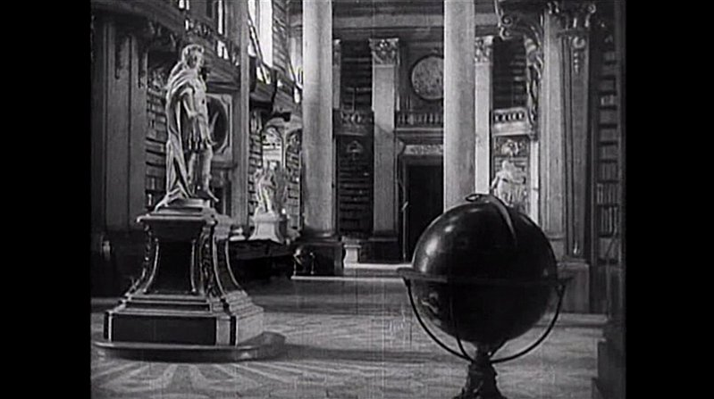

    on a 16/9 tv it should look like thisClick image for larger version
    on a 4:3 tv it should fill the entire screen.
