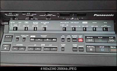

  1. I just bought a Panasonic AG-1980, and the VCR appears to be in good condition. I will admit that I am overwhelmed with the amount of controls on the front. Right now, I want to convert my VHS-C tapes (not S-VHS-C) to digital. Do you have any recommendations as to what settings I should use on this VCR?
    I am planning on passing it through a DMR-ES15 DVD recorder, and capturing it to a Diamond VC500 USB device. Is there any benefit of enabling two line TBCs, one from the AG-1980 and the other from the DMR-ES15?

    i ordered a similar high end panasonic VCR (PAL version) and still waiting for the delivery. you need to try different settings and compare. i understand that sometimes TBC on gives you worse results.
    one thing i'm sure, you need to turn the picture detail switch in EDIT mode (upper left in the picture). the DETAIL position is also known as HQ and the NOR is noise reduction of course.
    No. If the 1980's TBC is ON, the ES15's line tbc will have no effect but its frame-sync tbc will be working.
    If the AG-1980's TBC is OFF, the ES15 will handle both the line and frame tbc functions. It's just possible that you might not need the ES15 anyway. If you get a lousy noisy crap tape and you see the DNR softening or smearing the image, turn the 1980's TBC/DNR off and just use the ES15. Noise can be fixed. Smear can't.
    Default position for sharpness (PICTURE) is a notch in the mid-scale position. If you see too much noise or halos, lower sharp to the left. The switch just below the PICTURE slider should be = NOR. The DETAIL-NOR-EDIT switch should be on NOR. Search SOUND = Off. In your image you have "S-VHS" = ON. If you're not playing s-vhs tapes, turn it OFF.

  4. one thing i'm sure, you need to turn the picture detail switch in EDIT mode (upper left in the picture). the DETAIL position is also known as HQ and the NOR is noise reduction of course.
    Doesn't NOR mean neither? I thought the AG-1980's TBC combines with the DNR when enabled. Also, I am confused about what edit means in this context.
    I think I would need it for frame sync. I don't want to drop many frames like before.
    I would think that maybe it would work better if it is on, even for regular VHS. Are my tapes even S-VHS?

    i don't have the AG1980 model and could be wrong, but the EDIT setting disables noise reduction in most VCRs and it's recommended for copying video in the user manuals. did you read the AG1980 owner's manual?
    The DNR belongs on +NOR+, which stands for N O R M A L.
    No, you can't turn it off.

  8. i don't have the AG1980 model and could be wrong, but the EDIT setting disables noise reduction in most VCRs and it's recommended for copying video in the user manuals. did you read the AG1980 owner's manual?
    It suggests that I set it on EDIT for tape duplication, which is similar to what I want to do. So if this turns off the DNR, why are there threads that state enabling the TBC also enables the DNR?
    The EDIT setting is for recording and tape dubbing. Normal play is (guess what?)...NOR.

  15. So I should use the EDIT mode when capturing?
    Also, do I need to change any audio switches? It seems like they are for recording, according to the manual.

    EDIT bypasses all of the so called VHS HQ circuits which basically do this: low-pass the picture horizontally (read: blur) to reduce noise in the most primitive way and then apply some horizontal sharpening to counteract it. The amount of blurring and re-sharpening can be adjusted with the PICTURE (sharpness) slider. In EDIT mode the PICTURE slider becomes inoperative – you get a raw picture. It's a bit noisier but you also get more detail (well, depends on the tape).
    I have an NV-FS 200 which is the European version of the AG-1980 and I use EDIT only. TBC can be on or off, depends on the tape and capture hardware.
  17. Hypersonic1, you will need to personally test each combination of settings to see what YOU prefer. No one here can tell you as an absolute "you must only use this particular setting". The AG-1980 was a one-off, goofball VCR with a staggeringly broad range of performance variation from unit to unit (which gets more exaggerated as they age). Each AG-1980 will exhibit different characteristics at different settings that will strongly interact with your specific tapes and capture device.
    You quoted my reply to a related question in a different thread: my use of the term "pixelation" there was in direct response to that member, who used the term in his OP to describe an effect he did not like. For those who might be confused, LMotlow interpreted that exchange correctly to mean "what happens when typical VHS color nosie and grain are encoded to lossy codecs without cleanup, and especially to low-bitrate encodes directly to something like MPEG or h264 during capture...."
    Back to YOUR question: the North American AG-1980 / AG-5710 has significant differences from the similar (but not identical) NV-FS200 PAL version. The PAL model has more noticeable visual effects between various settings, and seems to allow independent activation of TBC and DNR. The AG-1980 / 5710 has a separate on/off switch for the TBC, but the DNR cannot be disabled: it is always in the signal chain regardless of the DETAIL-NOR-EDIT switch. The effect of that switch on PQ is very subtle in most AG-1980s: the obvious cut-and-dried "always use the EDIT position" doesn't necessarily apply when dubbing from AG-1980 to digital capture. I have owned nine of these VCRs, despite dramatic overall performance differences they each had minimal reaction to the DETAIL-NOR-EDIT setting during digital transfer.
    The EDIT setting was designed specifically for analog dubbing to another VCR: a lot of people assume EDIT is "always best" even for digital capture, but YMMV (in spades). In my experience, EDIT boosts the noise floor more than anything else and I don't find that the least bit beneficial for digital transfer. It did help with tape-to-tape dubbing in the old days, as the analog process fudges the noise while boosting visual detail slightly over NOR or DETAIL settings. But I find digital capture locks on the boosted noise at the expense of any PQ advantage, so when running an AG-1980 to digital, I usually prefer the DETAIL or NOR settings in concert with the PICTURE slider.
    It is very subjective and subtle, as I said there is no way to know what you'll prefer until you try the various settings yourself. Most significant is the AG-1980 does allow disabling the TBC (I rarely turn it on, the DNR is always helpful but the TBC effect is unpredictable tape to tape). If you do have tapes that require line TBC, the strong one built into the AG-1980 is usually sufficient. The ES-15 passthru may not be any better or even as good: the only ES model with "astounding" TBC passthru was the ES-10.
