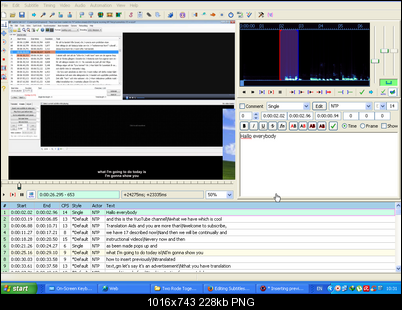

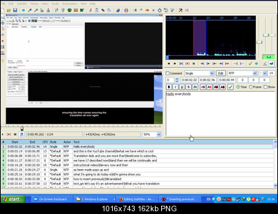

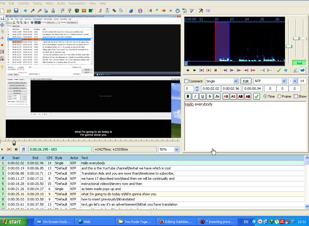

  3. Member Budman1's Avatar
    Jul 2012
    NORTHWEST ILLINOIS, USA
    Convert to ASS or SSA (I recommend SSA because some players do not handle ASS additional attributes) as El Heggunte mentioned and add an additional line as 'Single' and then change the Vertical Margin to 0 for double lines (containing /N code) and 10 for single. You may have to vary off of this depending on different factors.
    [Script Info]
    ; This is an Advanced Sub Station Alpha v4+ script.
    Title: Inserting previously translated text and time codes INTO your translation
    ScriptType: v4.00+
    Collisions: Normal
    PlayDepth: 0
    [V4+ Styles]
    Format: Name, Fontname, Fontsize, PrimaryColour, SecondaryColour, OutlineColour, BackColour, Bold, Italic, Underline, StrikeOut, ScaleX, ScaleY, Spacing, Angle, BorderStyle, Outline, Shadow, Alignment, MarginL, MarginR, MarginV, Encoding
    Style: Default,Arial,20,&H00FFFFFF,&H0300FFFF,&H00000000,&H02000 000,0,0,0,0,100,100,0,0,1,4,0,2,10,10,0,1
    Style: Single,Arial,20,&H00FFFFFF,&H0300FFFF,&H00000000,&H02000 000,0,0,0,0,100,100,0,0,1,4,0,2,10,10,10,1
    [Events]
    Format: Layer, Start, End, Style, Actor, MarginL, MarginR, MarginV, Effect, Text
    Dialogue: 0,0:00:02.02,0:00:02.96,Single,,0,0,0,,Hallo everybody
    Dialogue: 0,0:00:03.19,0:00:06.85,Default,,0,0,0,,and this is the YuoTube channel\Nwhat we have which is cool
    Dialogue: 0,0:00:06.88,0:00:10.71,Default,,0,0,0,,Translatio n Aids and you are more than\Nwelcome to subscribe,
    Dialogue: 0,0:00:11.27,0:00:17.21,Default,,0,0,0,,we have 17 described now\Nand then we will be continually and
    Dialogue: 0,0:00:18.28,0:00:20.50,Default,,0,0,0,,instructio nal videos\Nevery now and then
    Dialogue: 0,0:00:21.26,0:00:24.27,Single,,0,0,0,,as been made pops up and
Name:	ScreenHunter_160 Aug. 21 23.04.jpg
ID:	33269Click image for larger version
Name:	ScreenHunter_160 Aug. 21 23.05.jpg

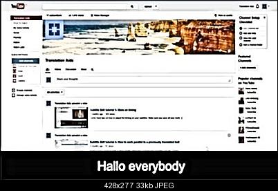

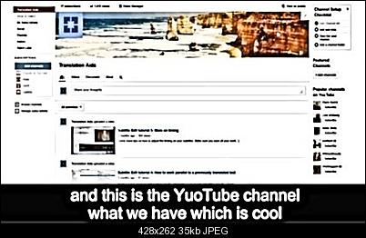

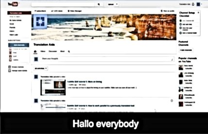

  9. I don't have what I want.
    Here is possition in SW 6.0 in full mode
    in SW 2.51 is Ok, but he doesn't have full screen mod
    in GOM-Player
    and in BSPlayer
    this is fine,
    but this is bad
    Both ass and ssa doesn't work.
    I try to change values, not successful.
    Can I make in Subtitle Edit positioning with video preview just for one line, save script, and than applay for all single lines? I mean, move line up and down to rich desired possition.

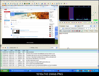

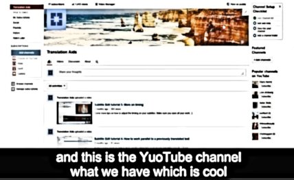

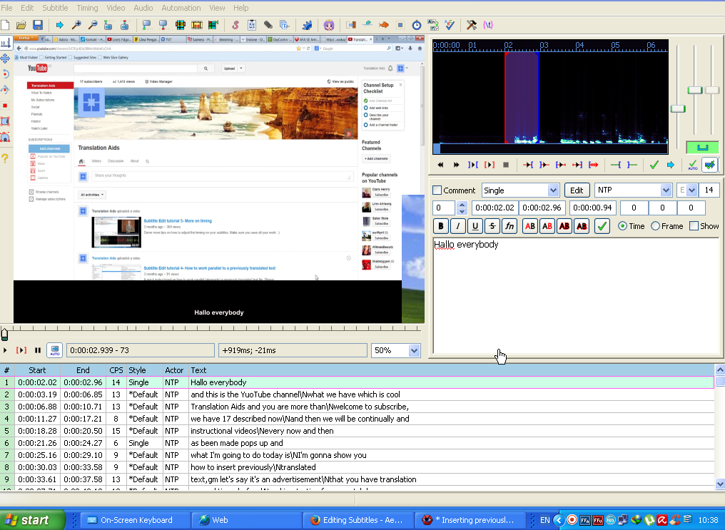

  12. Originally Posted by AdamSwing View Post
    I have never use the MEGUI, cause it's more professional and complicated. I have been using Aegisub because it's easy and helpful for the normal need of subtitle. I think adjusting the position of subtitle is very simple for you to achieve in Aegisub. You can try it.
    I tryed, with ssa in attash, not successful
ID:	33305Click image for larger version
ID:	33306Click image for larger version
    Also, look depends of media player
  13. Sorry, here is ssa in attach

  20. I attach a screen recording of what I would do with the subtitles in post #26. And I know as much of Potplayer as I do about BSPlayer. Nothing.
  21. Originally Posted by videobruger
    ;2406679
    Excellent, THANK YOU, I'm very happy with your solution for VLC. I wouldn't change nothing in your ssa. It will be great if there is a way to became independent of player. Otherwise, VLC is quite acceptable.
    Just to find way to mix this ssa with video... I think the way is konvert video in mkv, and mux ssa in MKVToolNix.
    And maybe VLC can do this, while seems to me I saw something on YouTube about that.
    It's time to end this marathon, after mixing, final recommendation shoud be: "Please, for best performance in wathing this video, use VLC PLayer". Your opinion?

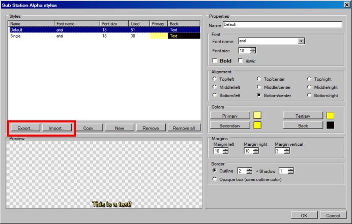

  25. I mean on this, when new subtitle is loaded, do something like Style - > Import ssa style from file -> your file. This is what I wish. I be grateful for another short video.
    Grrr... I will eat SE (or he will eat me).
  26. Rigth-click -> Sub Station Alpha Styles..
    (or you can copy-paste in Notepad:
    Style: Single,Arial,18,8454143,65535,65535,-2147483640,-1,0,1,2,1,2,10,10,13,0,1
