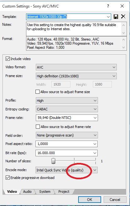

    1- Using "Internet 1080 30p" template as base, changed FPS to 60 and selected QSV in "quality" mode:

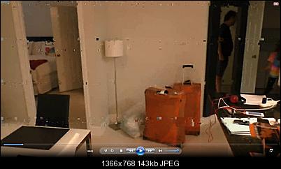

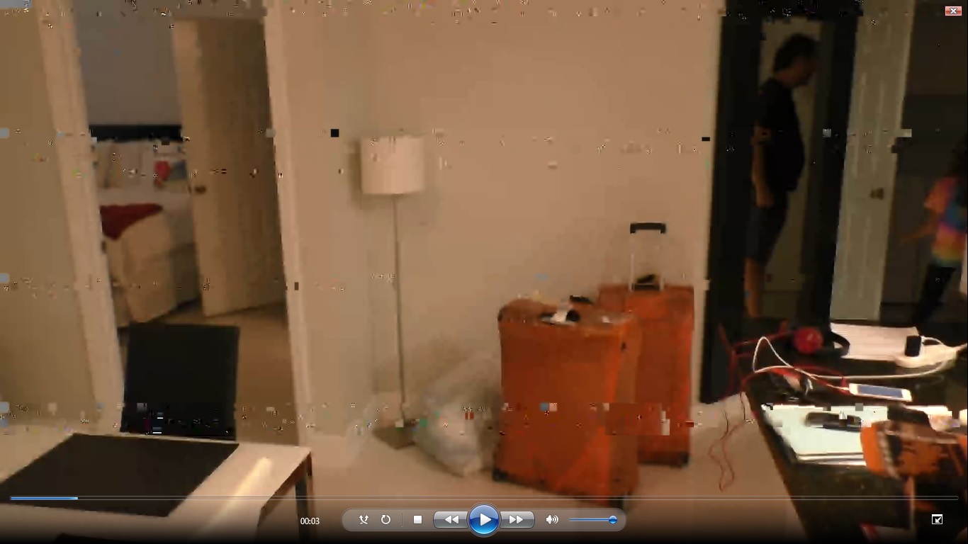

    Result: Video renders in half the time as expected but final file is corrupted showing artifacts and almost 1fps playback:

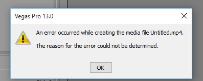

    2- Using same settings but QSV in "Speed" mode gives this error:
