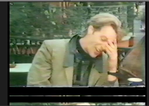

    I’m converting yet more old VHS tapes, using a Canopus ADVC 100 and a Sony SLV E1000. Between, I am using a Panasonic ES10 in pass through mode which does a wonderful job with everything else I convert.
    Sony SLV E1000 > Panasonic ES10 > Canopus ADVC 100 > FCP X
    I am using FCPX on a Mac for the process. Here's what I am seeking advice about:
    Please see the attached images.
    The black bars at the bottom are something I have not seen before.
    They do not appear on any other tapes I have converted.
    The 2 tapes they do appear on are from the same source.
    These tapes appear fairly badly damaged in terms of how the image looks when I bypass the ADVC unit – ie constant picture roll.
    Tracking via the Sony E1000 is already adjusted to optimal settings.
    Does anyone have any advice as to how I might rectify the problem, or am I stuck with these black bars?

  2. NTSC tapes captured in PAL mode? Ie, the capture device is expecting 576 lines but only getting 480. So the bottom 96 scan lines are junk.

  4. Based on the head switching being so high in the frame, another possibility: hard matted 1.66:1 (or 14:9) and one of the devices is confusing the matte for horizontal blanking.
    Ah! I will investigate this when I get home! Good idea to check. Thanks.
    Ok.. I know about aspect ratios, but have no idea what "hard matted" or "horizontal blanking"... whatever these are, if it is this problem, is there a workaround / solution...? Thanks!
  7. Hard matte wouldn't have head switching noise at the boundary of the active picture and matte. It's possible the tapes are PAL but incorrectly recorded from an NTSC source -- ie the error is already on the tape so it can't be corrected by setting the capture device to NTSC.
    If you can't fix the problem by changing capture settings (try bypassing the DVD recorder too) then you'll have to fix it by cropping away the bottom of the frame. You'll probably still have jerky motion because of the mismatched frame rates.

  14. I'm with jagabo - I think you have the Canopus box set up incorrectly. If this is a PAL tape and VCR and DVD recorder, make sure your Canopus is also set up for PAL.
    Makes no difference when I flip the switch - except that the image falls to the bottom of the screen instead of at the top. So that isn't it, unfortunately....
